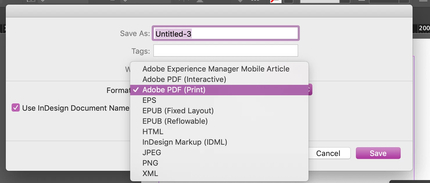

1. I am trying to save my document (which is currently in Adobe InDesign) as a PDF/X-1a:2001 file but there is nothing with that type of file under 'save as'.  How do I do a save the file as the PDF/X-1a:2001?

June 20, 2021
File> Export > Adobe PDF (Print)

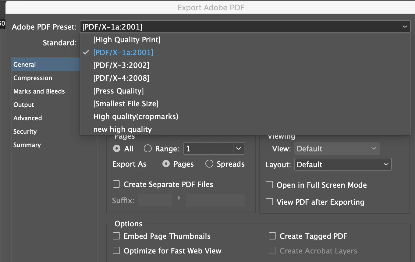

June 20, 2021
If you look in the File > Adobe PDF Presets you'll find it there. Presumably, your printer has specified this version (PDF/X-4 is the current version).
Unless your printer has specified otherwise, select in the Export Adobe PDF dialogue box under the General tab Export as Single Pages (not Spreads) and under the Marks and Bleeds tab tick Crop Marks and Use Document Bleed Settings.
