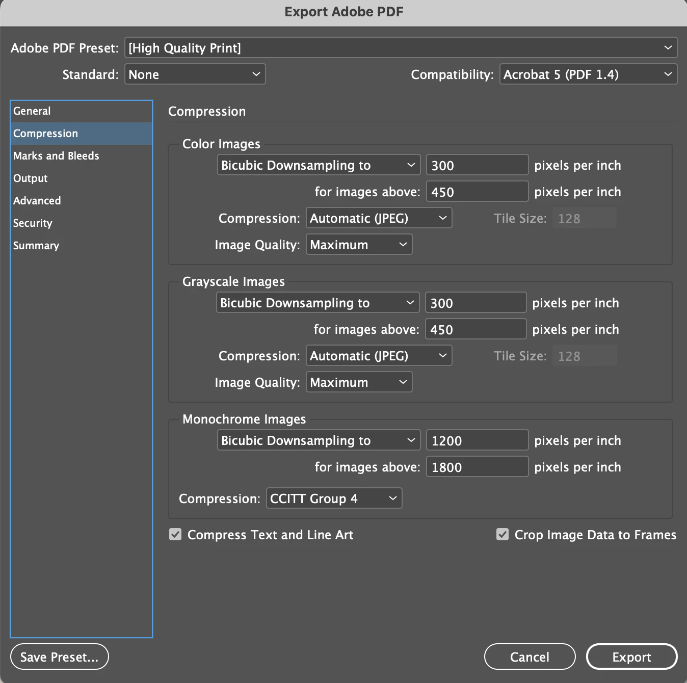

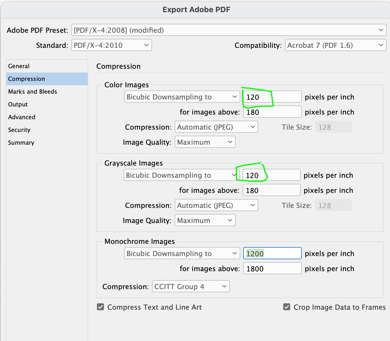

As far as how to export, just change your settings for image resolution on Export.

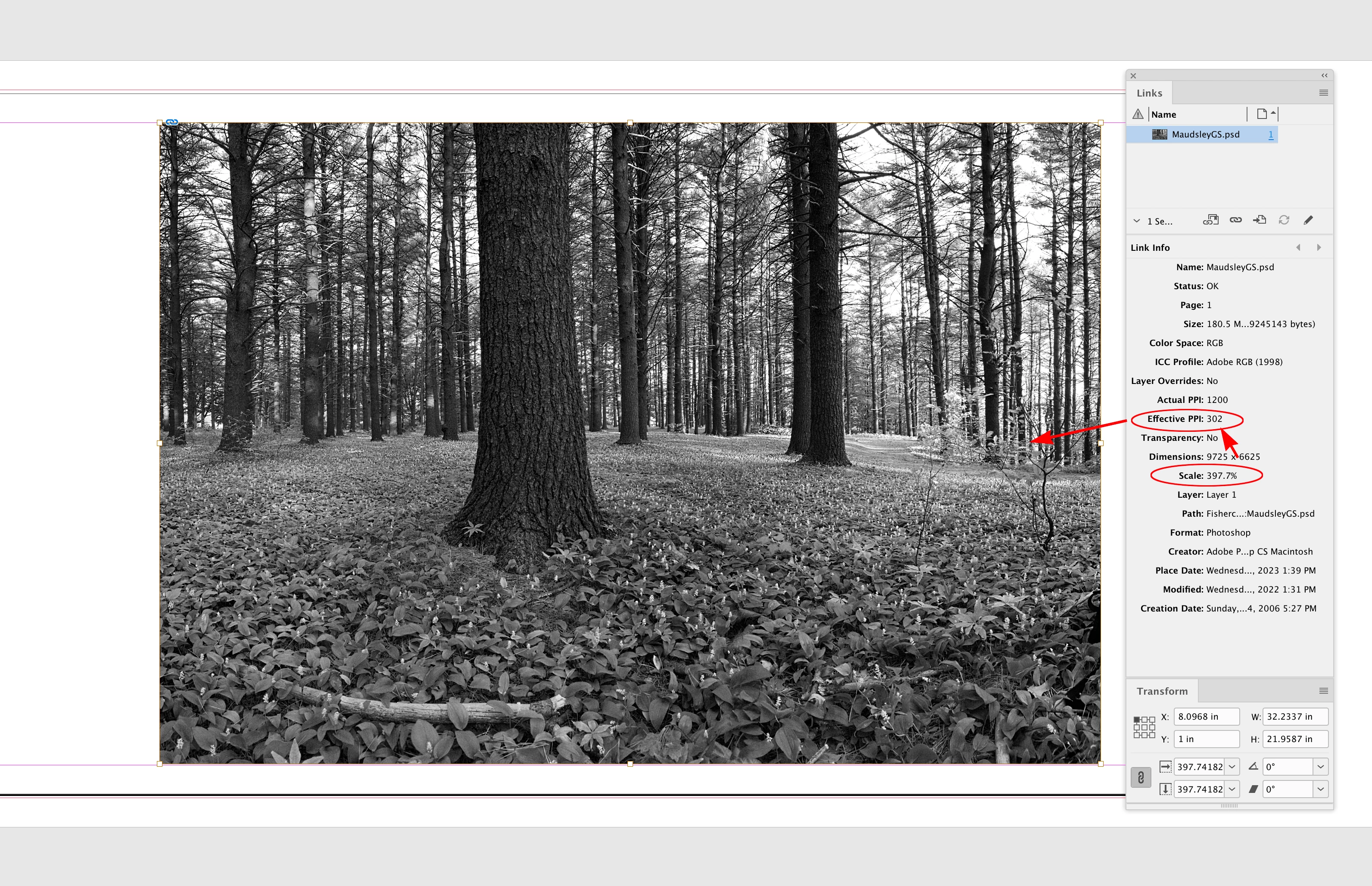

Hi @tatum_ellise , The printer is asking that any images in your document have an Effective Resolution of at least 120ppi. If there are images placed in your InDesign Document check the Link Info panel, which will list the Effective Resolution (the scaled output resolution) and make sure the Effective Resolution is over 120ppi.
Also if the PDF is going to be scaled up at output, you would have to consider the print scaling—if the PDF will be printed at 200% the Effective image resolutions would have to be 240ppi in order to gt the 120ppi output resolution.

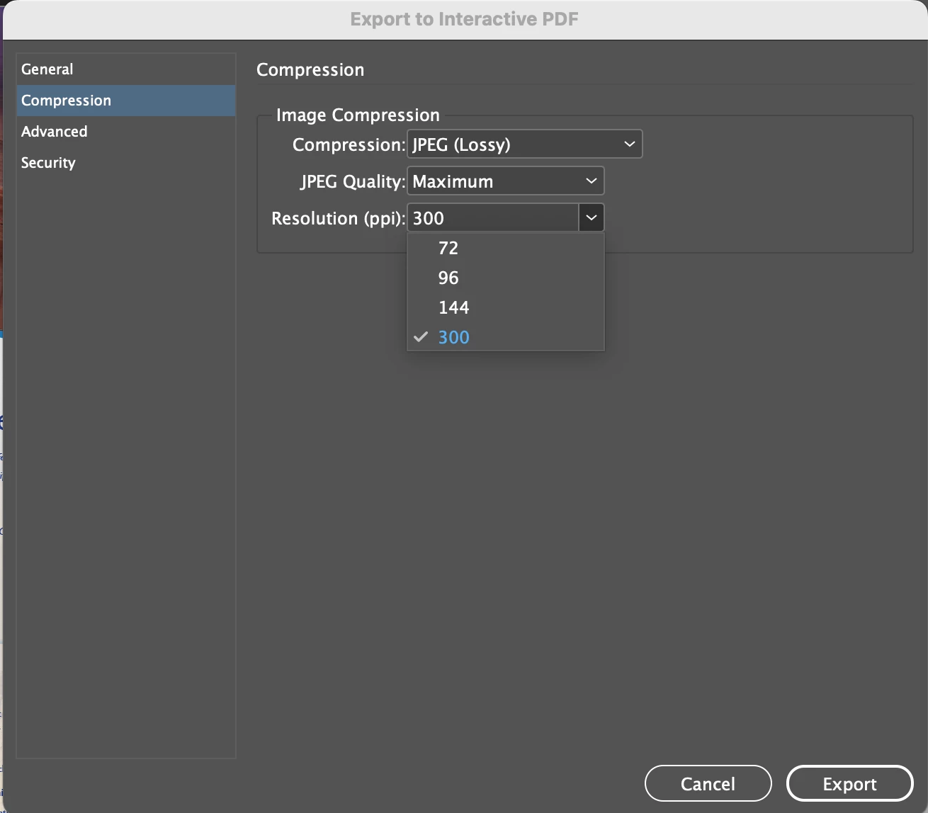

Eve for Interactive PDF, you can spicify its compression for images and res.
manal shanableh
February 1, 2023
If they mean PDF for print, difinitly they mean high quality print with this compression specification.
