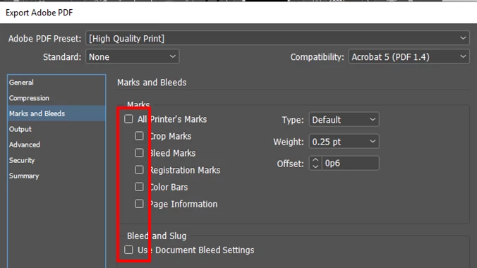

When I design a print layout (such as a 64 page booklet) with a bleed, when I save a PDF for web use, the sliver of the bleed is on the facing page in the PDF.  I tried changing the bleed to "0", but that didn't work.
How do I save a PDF without the bleed showing on the facing page??

    Are you exporting your document as PDF?
    Then when exporting ensure that the following options are Checked Off.
