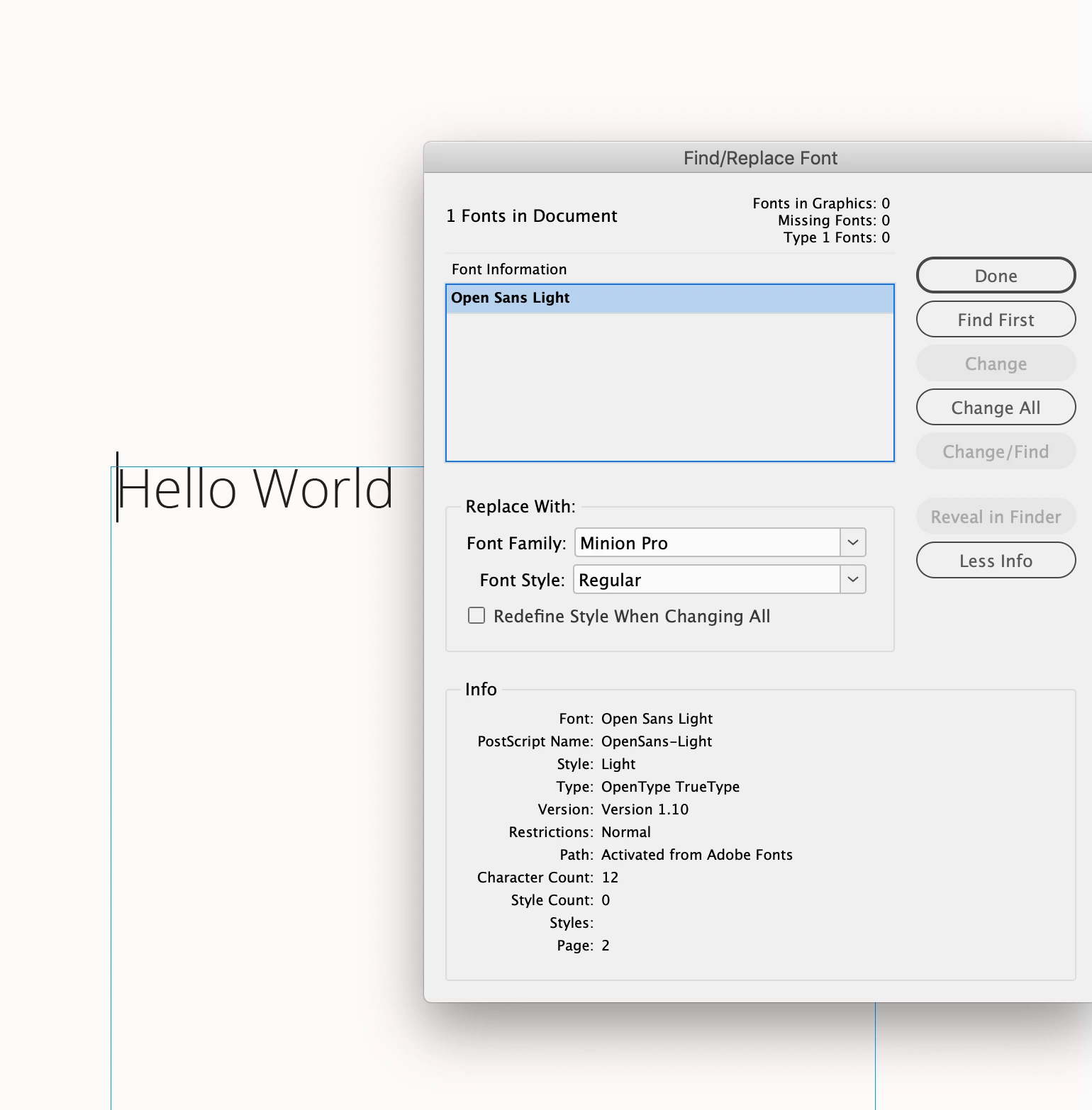

Hi @Electric_Mercury5742 , Also this has come up before, there is the free version from Google (3.003) and the Adobe Type version (1.10). The two versions are nearly identical but they have different Ascent lines which would show up if your text frame’s First Baseline Offset is set to Ascent.
The Adobe version is 1.10, the Google version is 3.0023—check Version in Find/Replace Font
The first Baseline Offest:

Hello @rob day ,
Thank you so much for your input!! This helped to find the root of the problem, now I can find a work-around!
