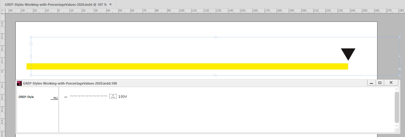

If you can relate an integer number in your CSV file to formatting of text. E.g. you could correlate the number and the width of a character in percentage.
Think of an inline anchored object, your position triangle, some white space characters with fixed width in front of it. The position of the anchored object represents the 100% mark. After the anchored triangle comes the text that is provided through data merge, a number in your case.

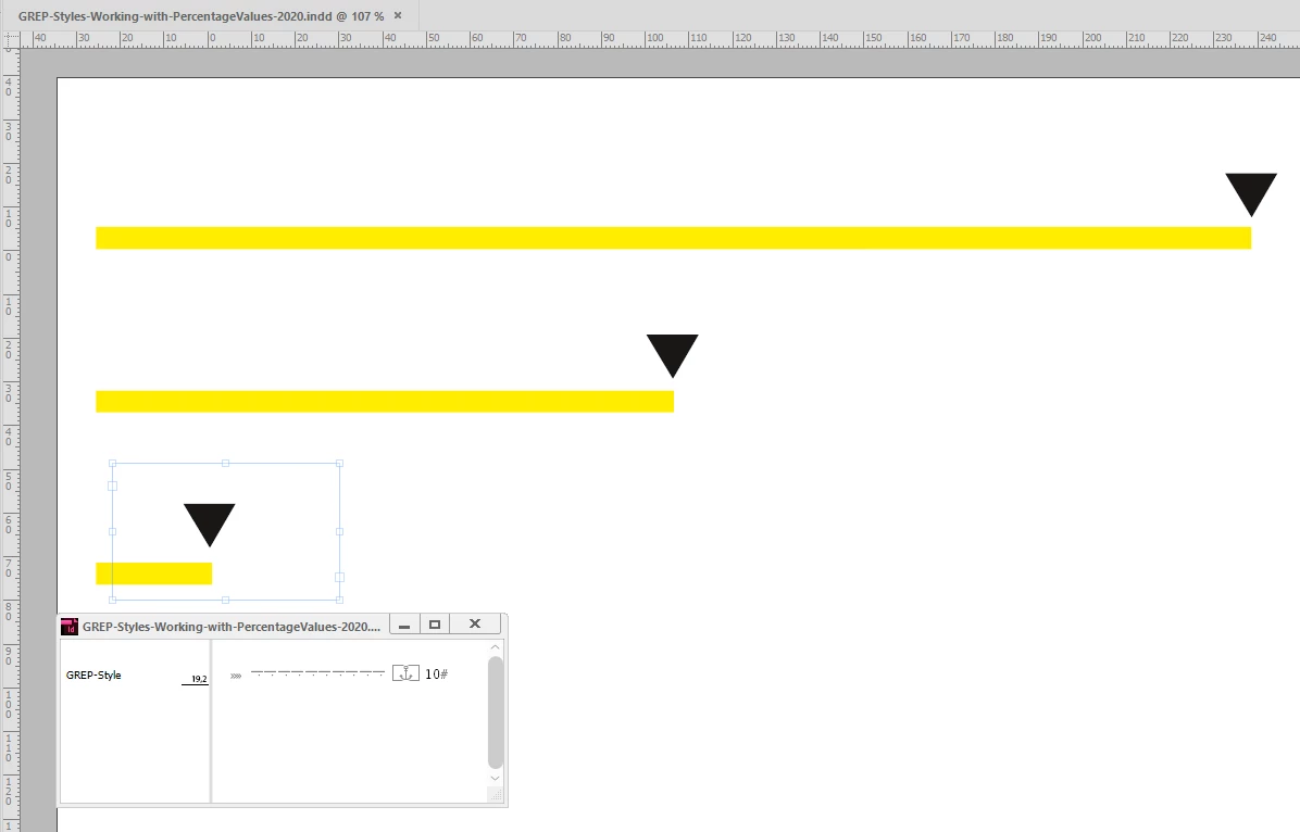

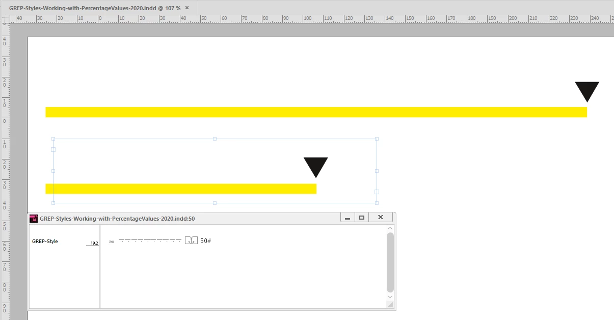

Example paragraphs with the 100% mark, the 50% mark and the 10% mark below.
Text in the paragraph is invisible, because I used fill color [None] for formatting.
The yellow bars are just indicators I added.
All screenshots done from my German InDesign 2020 on Windows 10:

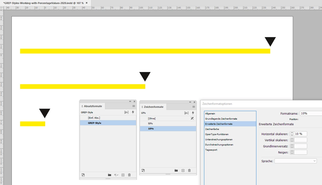

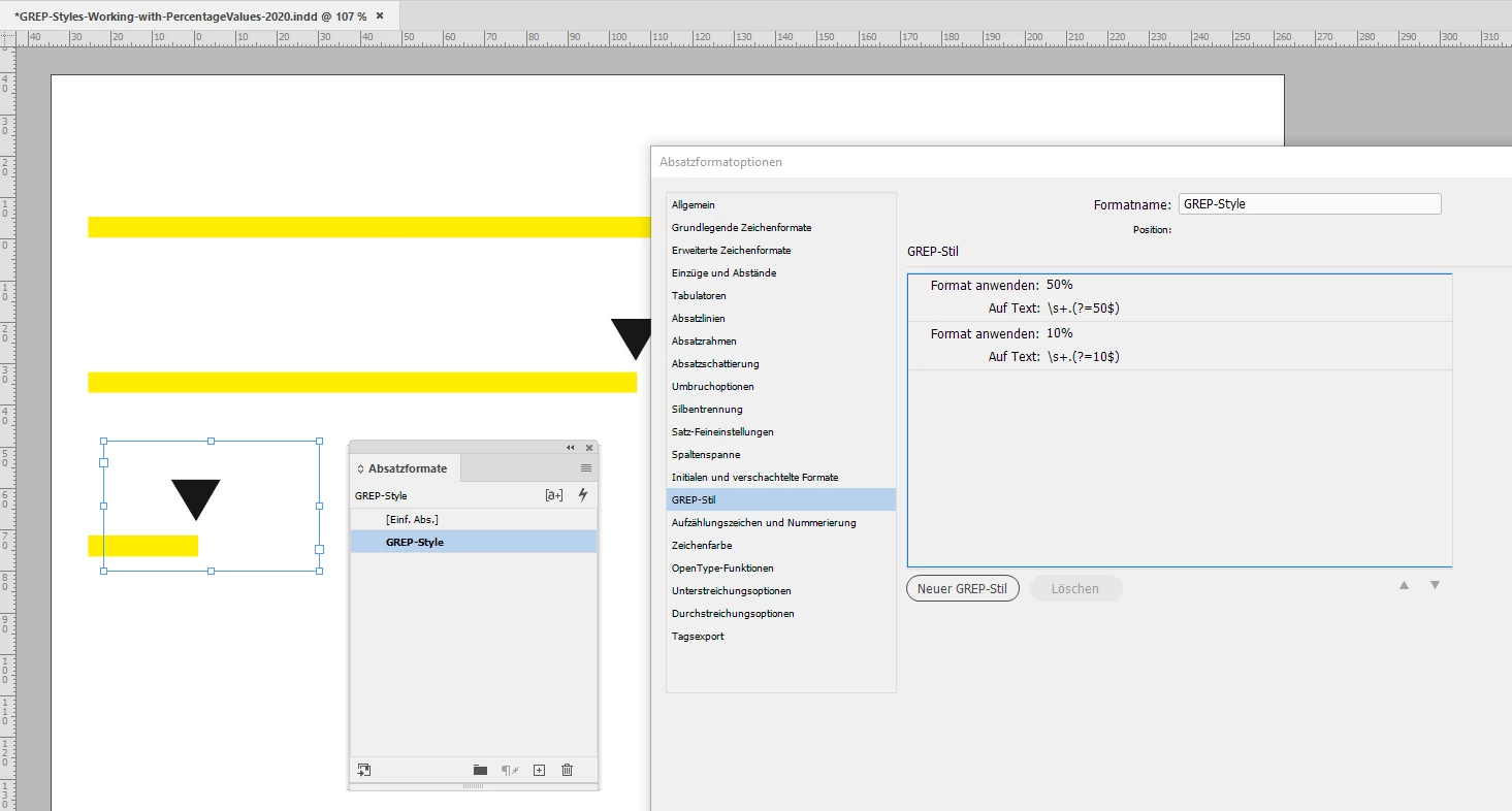

The paragraph is formatted using GREP styles. The GREPs are looking for numbers at the end of a paragraph with a positive lookahead. If a number is found, all the white space at the beginning of the paragraph is formatted with a character style. That character style will change the width of characters. Say, if number 50 is used, one of the GREP styles discover this and will format all white space at the beginning of the paragraph to 50%.
Below a sample character style, the one for 10% character width:
At first glance you need 99 GREP styles to represent all integer values from 1 to 99. Value 100 is default, so no GREP style is necessary to represent 100. Each GREP style triggers one of 99 character styles where the width of a character is defined in 1% steps.

Note: the total amount of GREP styles that can be defined with one paragraph style is 100.
