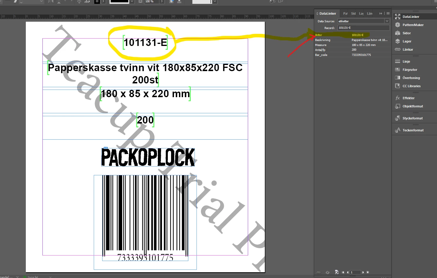

Here is the sample file that I have created. (Before I buy the software this is a testfile to see if this works as I want it too so this is made with the trial software.)
I have created the template, and linked information from the database as I want to.
I tested to do an export to separate PDF files and this works as I want it to.
The only thing left now is to be able to export these pages as separate PDF files with the naming I want it to have.
I have attaced the InDesign file. I have also attached an image of the item code I want to be part of the name. It's marked in yellow. The Item code is called "artnr" in the database I use.
I have also attached the sample database.
The software I will use is called Teacup DataLinker
The thing is, that I will create different template files for different types of products so the item number (artnr) will not always be in the same place as in the template attached.
Is it possible to get the script to collect the name from the data base?
I aslo want a prefix specifying what type of label it is. Outer packaging or inner packaging pallet and perhaps something else that I can't think of now, so I need to be able to change the prefix.
So it should be named
"Prefix Item code"
So for example " Outer packaging label 101131-E" or "Inner packaging label 101132-E"
Best regards Fredrik
Robert at ID-Tasker
Jan 21, 2025 6:02 PM UTC
I'm not sure you really need TeaCup for that...
It's simple enough for DataMerge - unless, you need to be able to constantly update / synchornise data...
