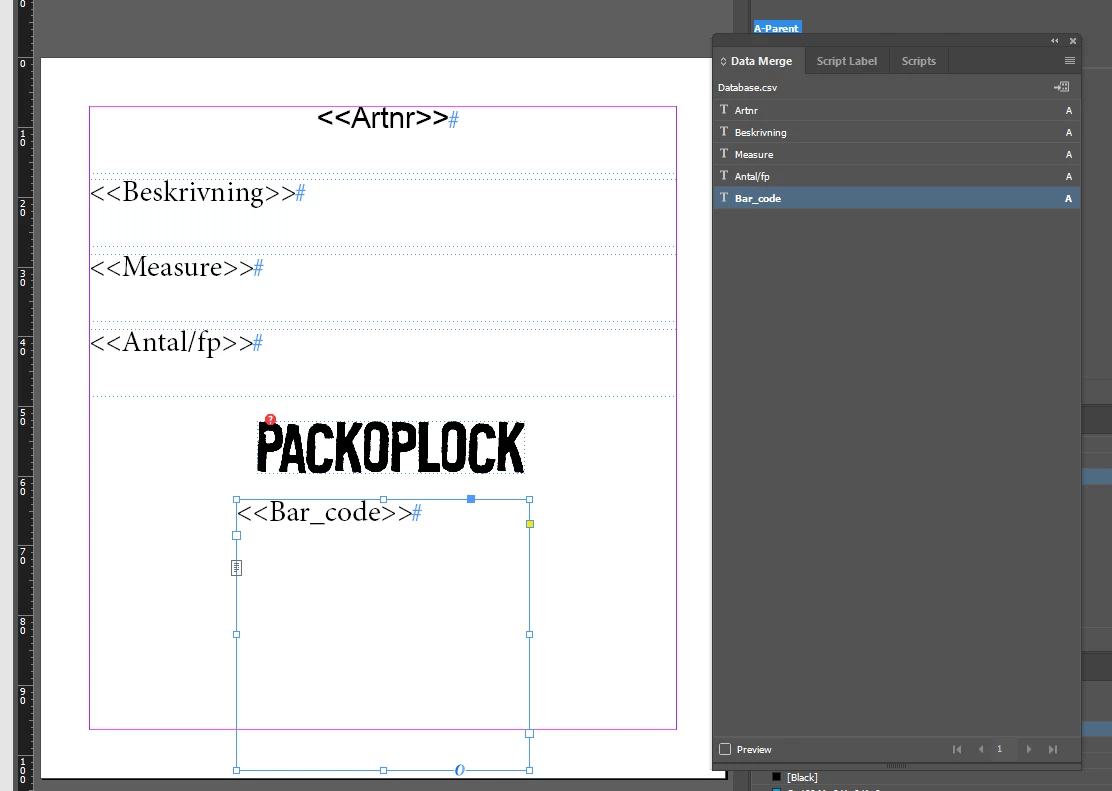

Here is an example of DataMerge solution - built-in free solution - but without export:

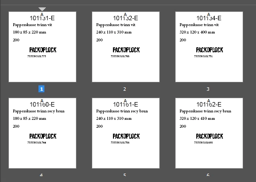

And here is an example of final document:
Of course you would've to do something with BarCodes...
Attached are both INDD files - DataMerge template and example file.
Database you already have - so just download those files to the same folder as your CSV file.
I've also re-uploaded IDML versions.
You'll get a lot of oversets - just edit ParaStyles - I made texts bigger for the Pages Panel preview.
