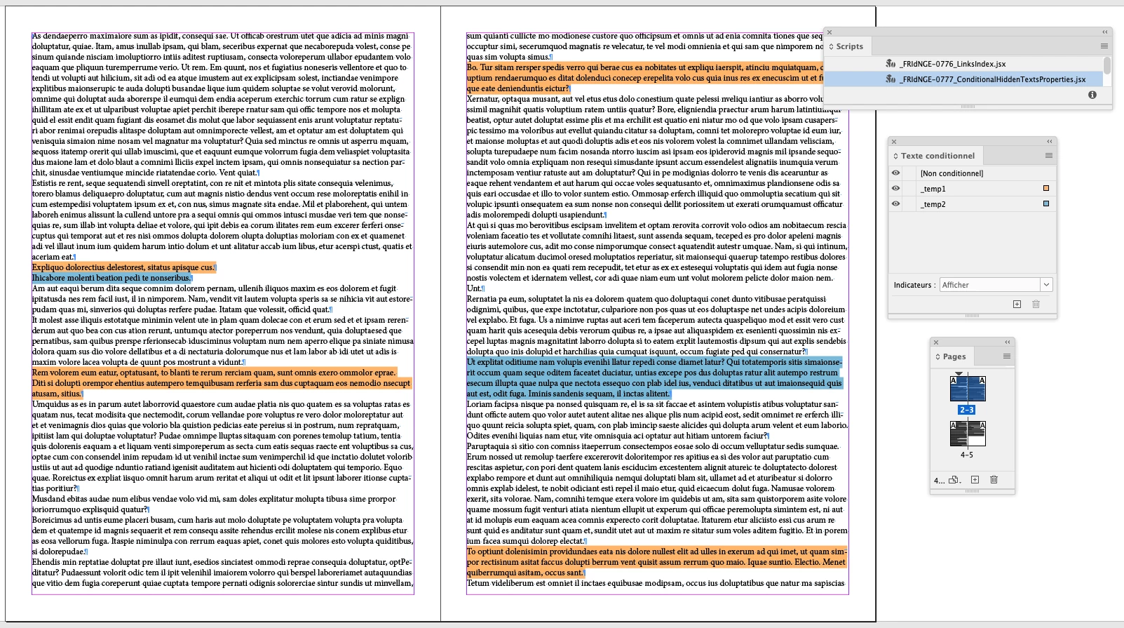

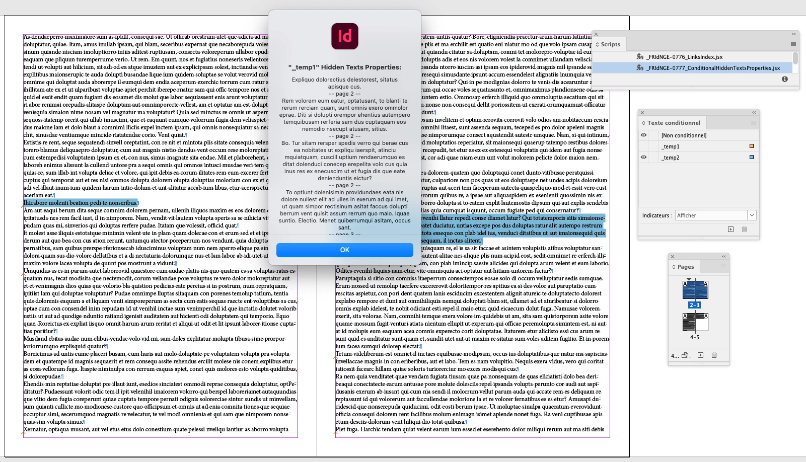

Jan 7, 2025 5:52 PM UTC
Based on "HiddenTexts"! …
The treatment is here on the masked condition called "_temp1".
The first screenshot shows the text with this condition applied (in orange):
The second screenshot shows how the Script works when this condition is masked:
Script Code:
    _FRIdNGE-0777_ConditionalHiddenTextsProperties.jsx
    Script written by FRIdNGE, Michel Allio [07/01/25]
var myDoc = app.activeDocument;
// Condition Name To Be Defined:
var myCondition = "_temp1";
var myHiddenTexts = myDoc.stories.everyItem().hiddenTexts.everyItem().getElements();
var H = myHiddenTexts.length,  h;
var myResults = [];
for ( h = 0; h < H; h++ ) {
    var myHiddenText = myHiddenTexts[h];
    if ( myHiddenText.texts[0].appliedConditions[0].name === myCondition ) myResults.push( myHiddenText.texts[0].contents + "-- page " + myHiddenText.storyOffset.parentTextFrames[0].parentPage.name + " --" );
alert( "\"" + myCondition + "\"" + " Hidden Texts Properties:\r" + myResults.join("\r") )
… To be adapted for your own use!  😉
(^/)  The Jedi

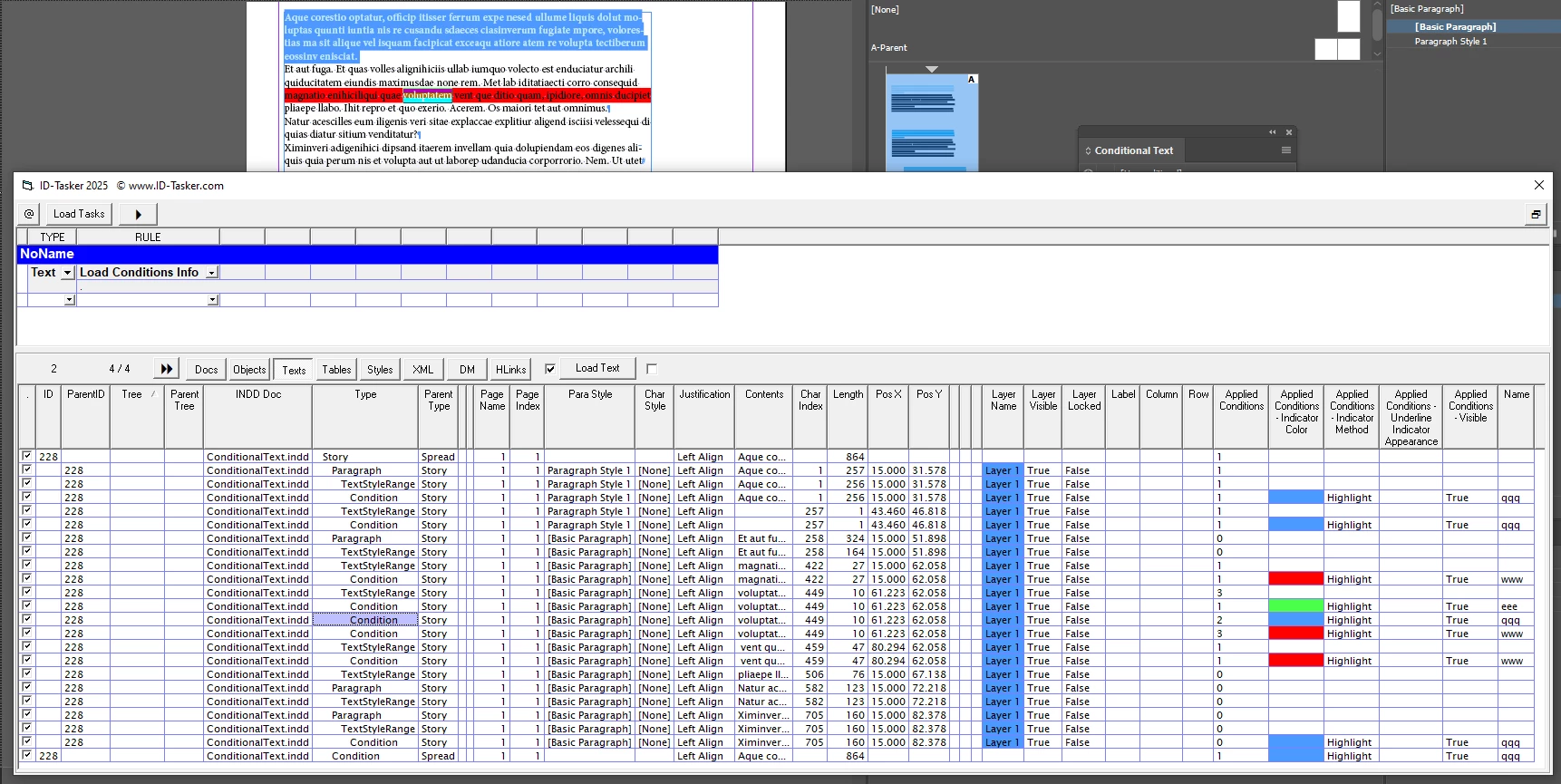

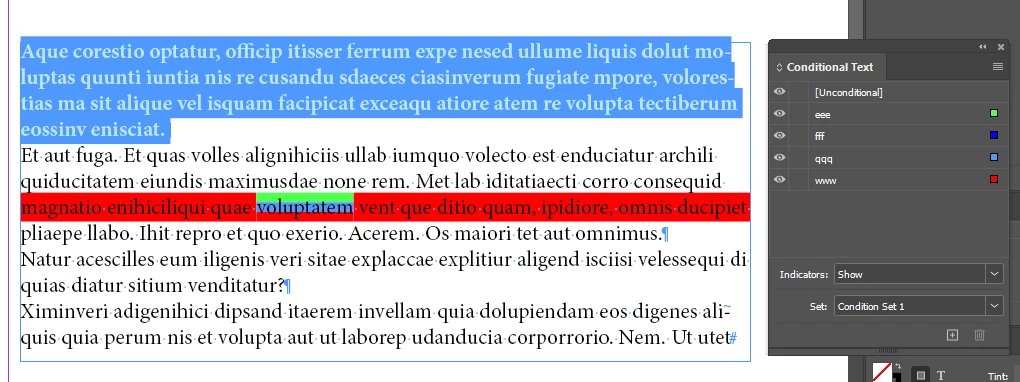

Jan 7, 2025 3:28 PM UTC
@jrsupplee
Get HIDDEN Texts first:
But then, you need to do a 2nd run on them - check which Condition(s) is(are) applied.
Screenshot shows raw text at the top with all conditional texts hidden.
Below you can see my ID-Tasker tool - this part is free - effect of first loading Hidden texts - then 2nd run that analyses those Hidden Texts and loads info about applied Conditions to them.
2nd, indented, copies of "HiddenText" should be renamed to "Conditional Text" - it's a quick test so I haven't done this yet.
CharIndex column is misleading - during 1st run, InDesign returns indexes of texts EXCLUDING hidden texts - so when I've done 2nd run - the 1st hidden text on the above list is in fact FIRST paragraph:
And there are no Page Names / Indexes - hidden textts don't have Parent TextFrames, Layers, etc.
There is one drawback - not sure if/how would you be able to store this information - but after showing Conditional texts in InDesign - when I try to access location of the Hidden Texts - loaded during 1st run, when conditions were hidden - InDesign return error that object no longer exists. Not a problem for my IDT - but it might be a problem for you.

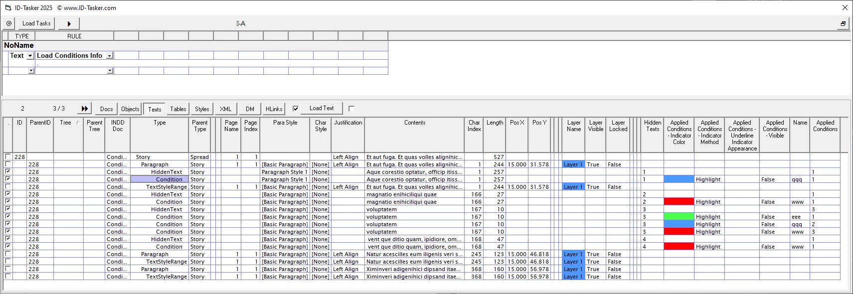

Robert at ID-Tasker
Jan 7, 2025 3:35 PM UTC
quote
And done:

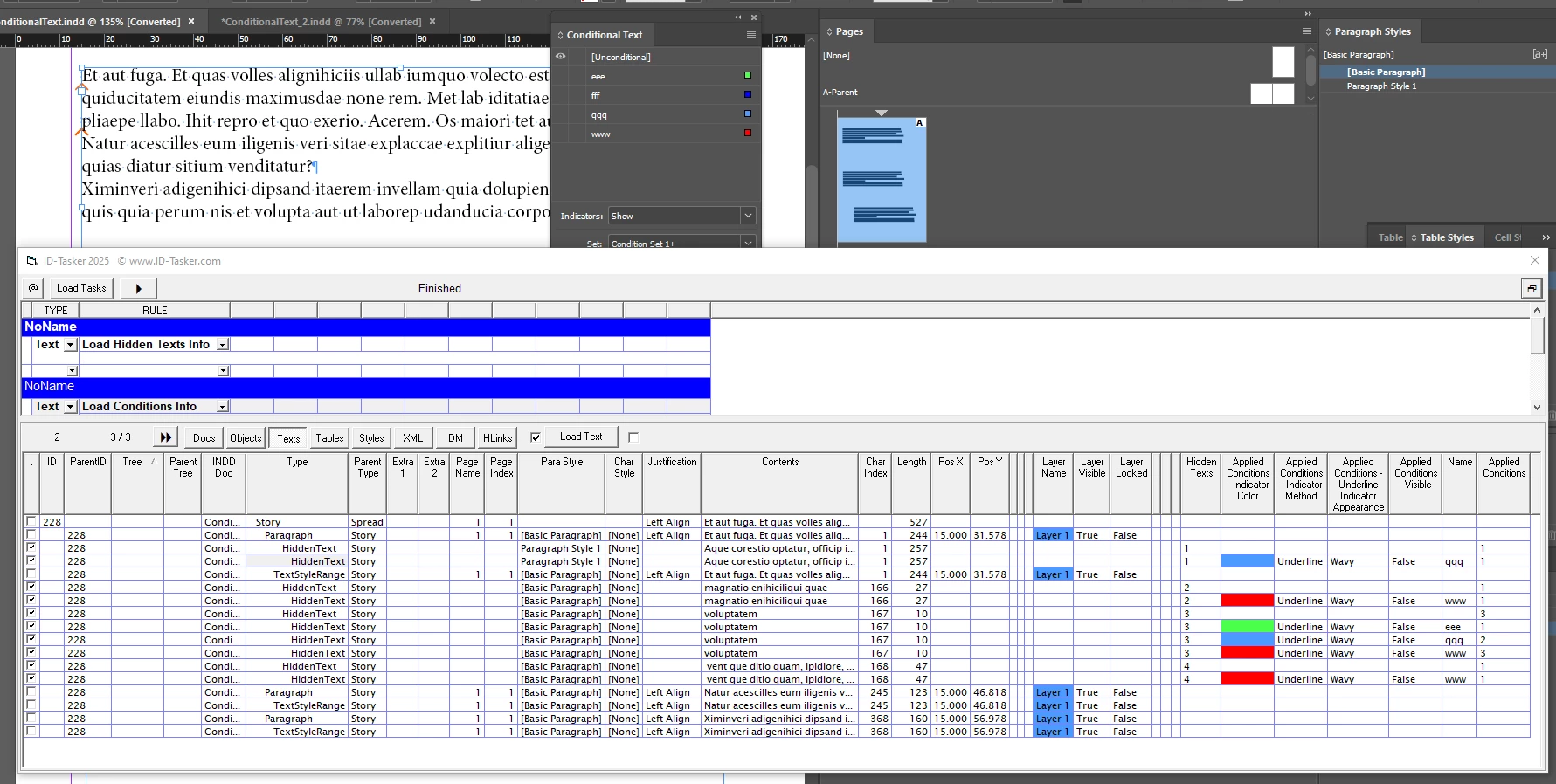

Robert at ID-Tasker
Jan 7, 2025 3:41 PM UTC
And Conditions only:
