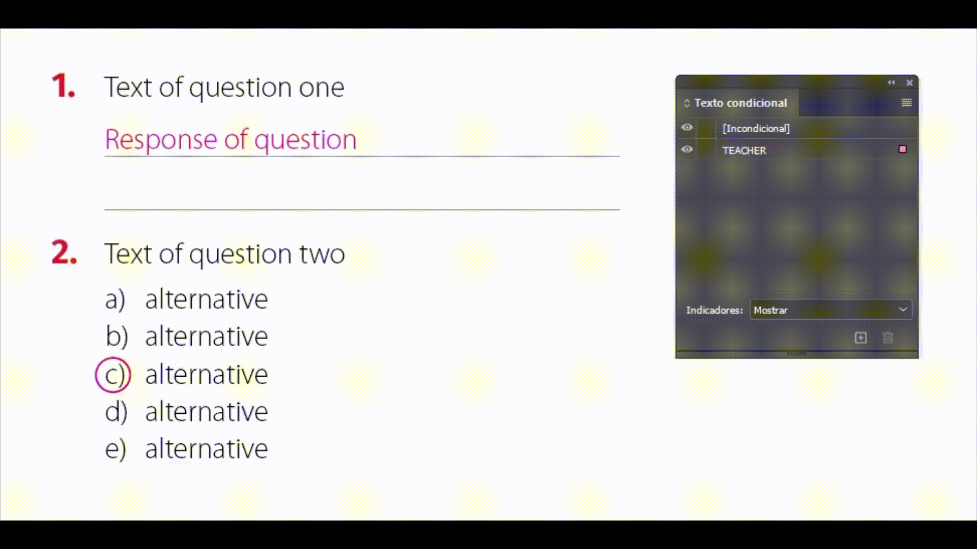

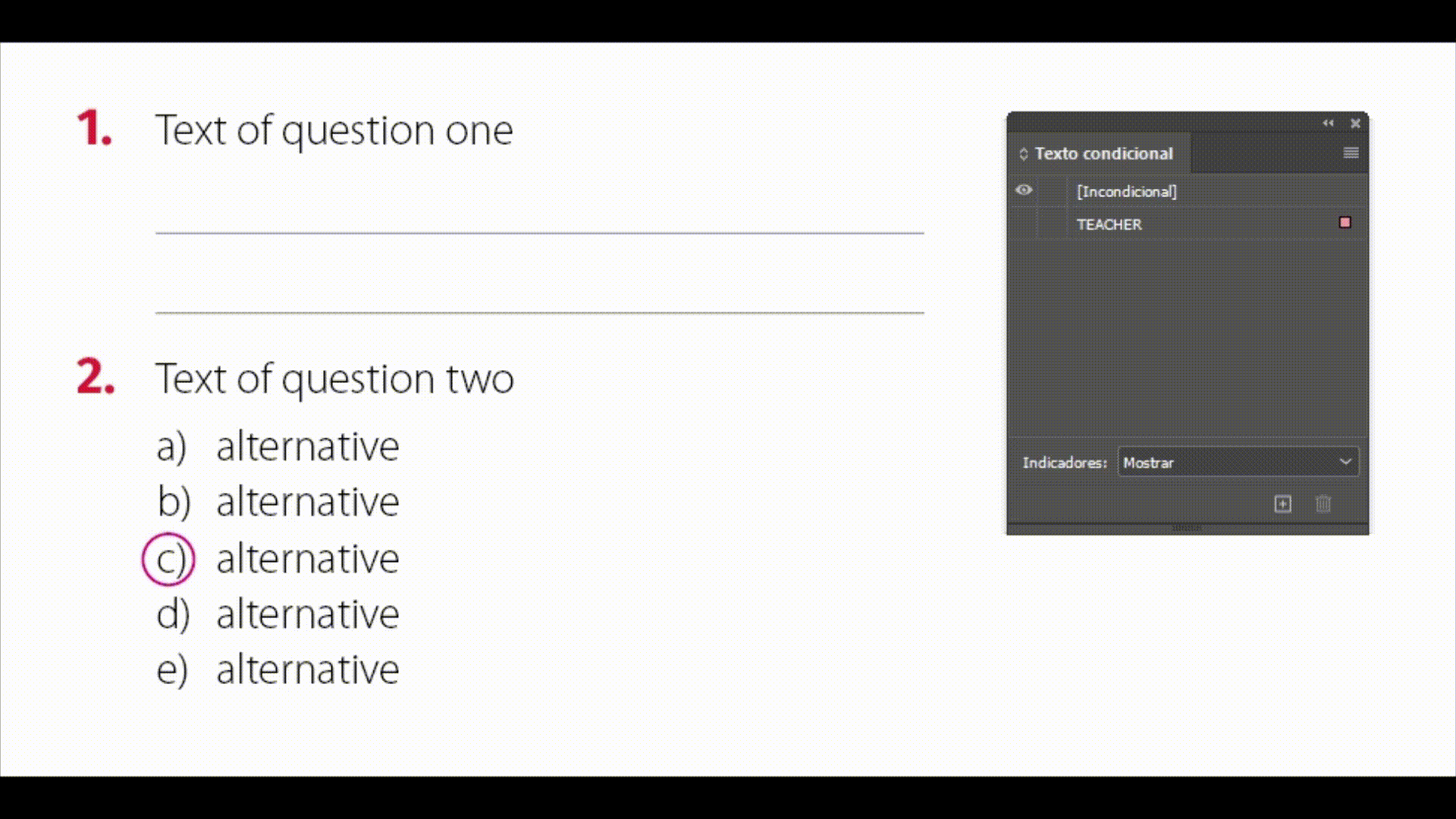

Hello everyone
I have a document that use a conditional text, and i need check how the text stay with or without the conditional, in many pages, today i do this showing and hiding the eye in conditional text panel, so, i am trying write a code for atutomate this task.
I am yet in begin
var delay = 50;
var stopCheck = false;
while (stopCheck == false){
    if (app.activeDocument.conditions.item("condition_name").visible == true) {
        app.activeDocument.conditions.item("condition_name").visible = false;
         $.sleep(delay);
        } else {
            app.activeDocument.conditions.item("condition_name").visible = true;
             $.sleep(delay);
the code worked, I know this because i see the eye in the panel changing, but in the document the text do not hide or show, I understand that InDesign freeze the view, while the script runs.
I try too use the invoke of menuActions, but the result is same
app.menuActions.itemByID(133136).invoke() // Hide
app.menuActions.itemByID(133135).invoke() // Show
somebody knows how i can resolve, or the reason for this
grateful for help

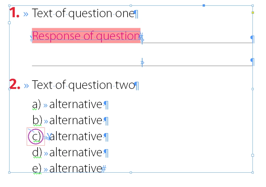

February 12, 2023
Hey folks
first I would like to thank you for your contribution, the tips opened up new possibilities here, I bring the results of the tests I did
Before explaining, better use of conditional text here:
I have been using it to export a pdf for students and teachers, the answers for the teacher are with the conditional text, and i export the pdf for the student with the conditional text hidden.
These responses are in their own text boxes and anchored to the main text.
If there is only text on the page, the .recompose() approach works perfectly, but in some cases the response is a vector, a circle to mark an alternative, which I anchor to the text, and apply the condition to just the anchor character, in these cases recompose() interferes with the visualization of the main text.
Here if I unanchor the circle, the script does not interfere with the visualization of the main text, but precisely because it is no longer anchored, I lose the function of the conditional.
I'm still doing tests here.
@m1b I was curious about the approach with idleTasks, but I can't get it to work here, the message "The requested action could not be completed because the object no longer exists". appears when run, I could not understand. I am use the ID 18.1
