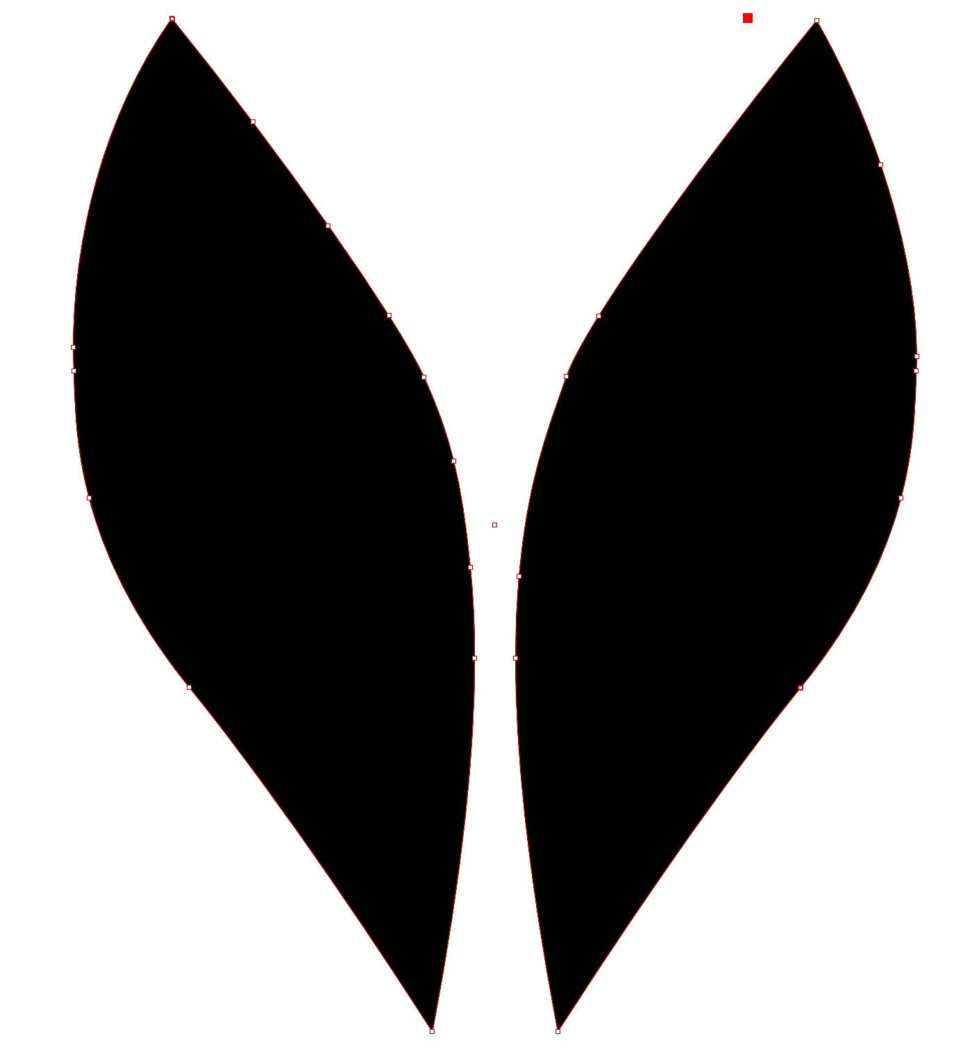

I am looking for a script that will work similar to Zamena script (for Illustrator). I need to swap the geometry of a bunch of objects that I've created in InDesign. After I made many, many copies of the object in question, I took a closer look at the bezier curves and they are not as clean as I would like. So I want to swap their geometry with a newer cleaner version.
Does such a script exist? I'm not a scripter, and I don't know any coding languages, so this is not something I can write for myself.

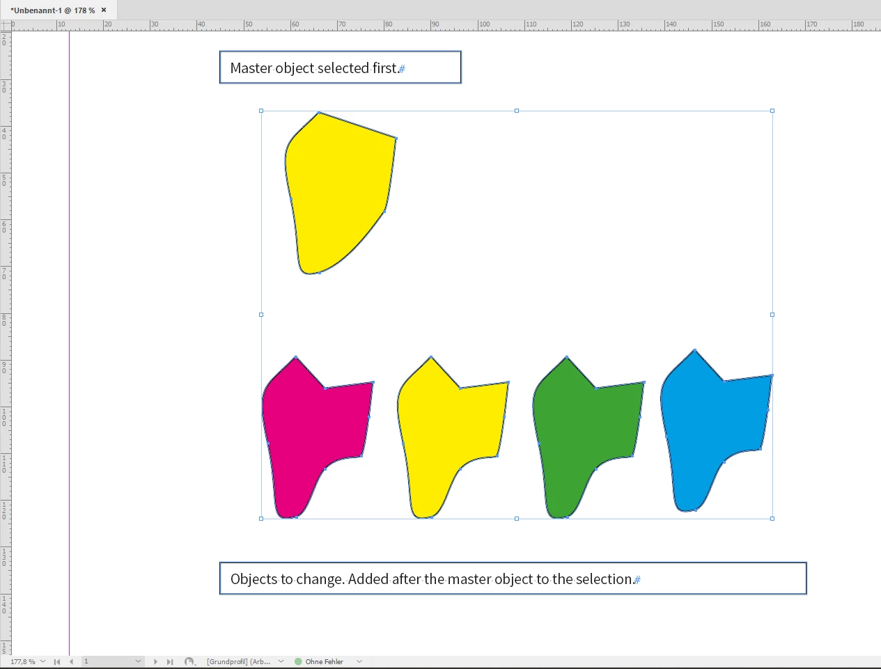

To illustrate what my script is doing.
Before running the script on that selection:

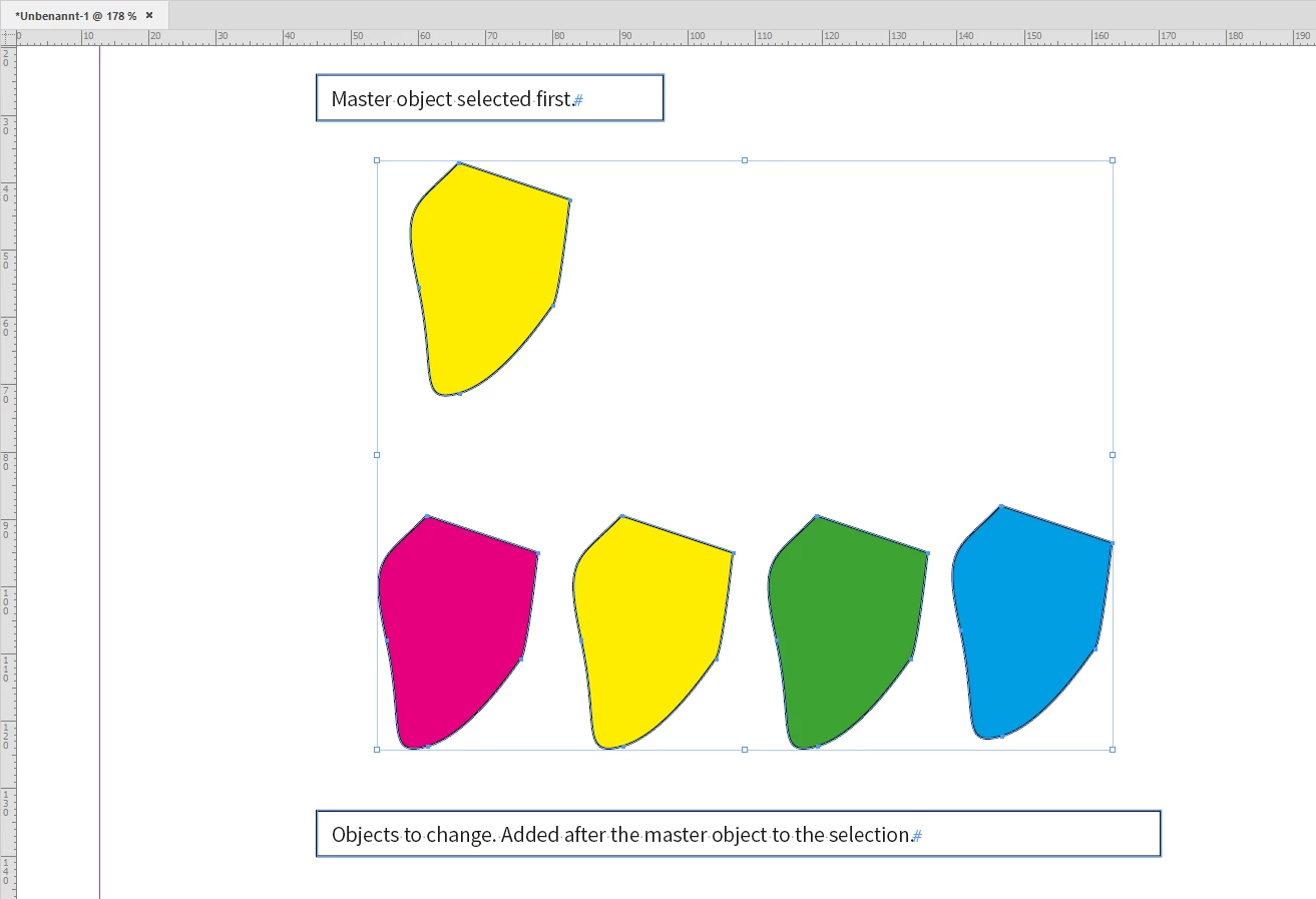

After running the script:
Path and position of the master is applied to all selected objects.
All other properties like stroke weight, stroke color, fill color are not transferred.

Wow, Uwe, thant's great! Your script works wonderfully! Thank you so much. 🙂

Then an ad-hoc script from my side could do the trick!
[1] Select your new master object first
[2] Then add all other objects you want to change to the selection.
[3] Run that script code on your selection:
var s = app.selection ;
var m = s[0] ;
var mp = m.paths[0].entirePath ;
for( var n=1; n<s.length; n++ )
	var xy = [ s[n].geometricBounds[1] , s[n].geometricBounds[0] ];
	s[n].paths[0].entirePath = mp ;
	s[n].move( xy );
It should work if the objects are no compound ones and have only one path each.
