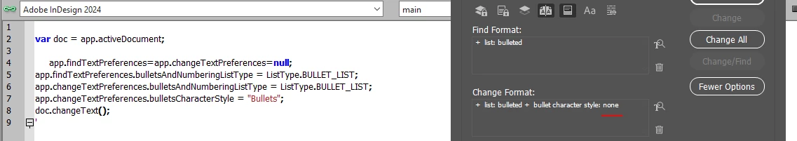

Hi everyone,
I'm trying to figure out why my Find/Change is not recognizing a character style ("Bullets") when I run the script below. Should I change anything on line 7?
Thanks for checking!
Rogerio

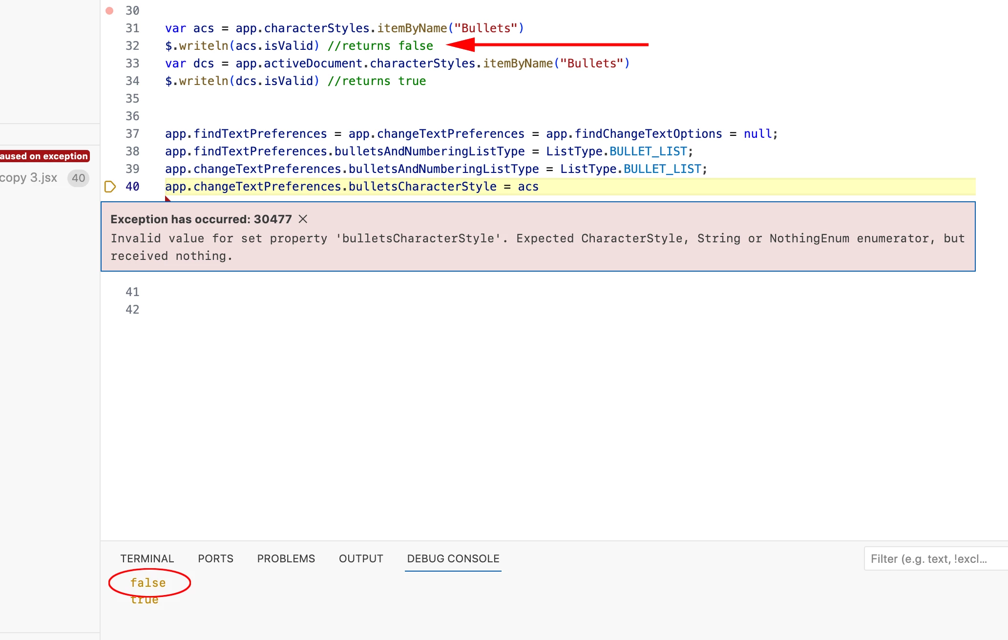

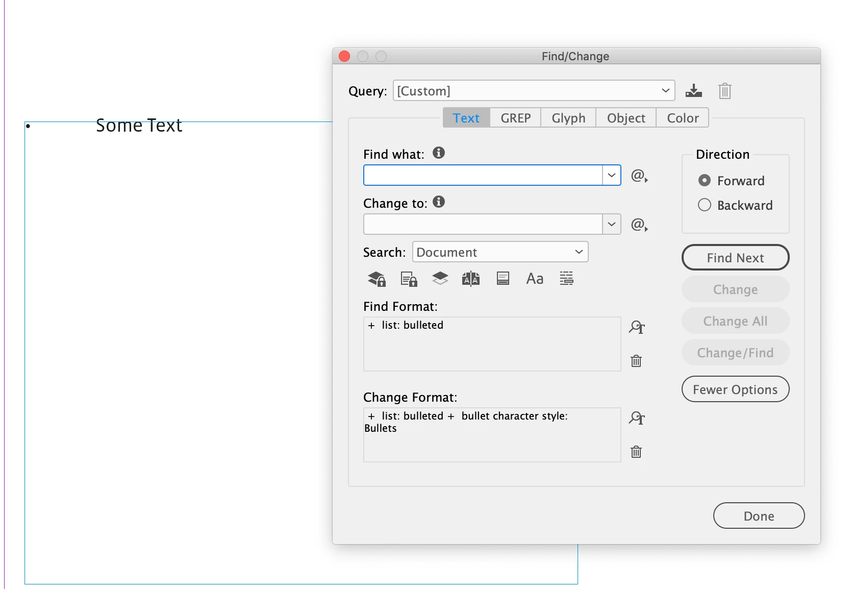

Hi @Rogerio5C09 , I think the problem is app.changeTextPreferences.bulletsCharacterStyle is looking for an application (not a document) character style. So if I create a new document with a paragraph style that is referencing a document character style named "Bullets", and run this, I get false for the app characterStyle and true for the activeDocument character style:
var acs = app.characterStyles.itemByName("Bullets")
$.writeln(acs.isValid) //returns false
var dcs = app.activeDocument.characterStyles.itemByName("Bullets")
$.writeln(dcs.isValid) //returns true

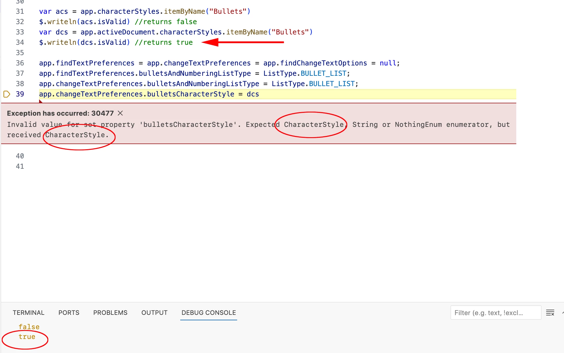

If I reference either the acs or dcs variable rather than a name string with your script I get an error:
If I create an application level character style (all documents closed) named Bullets, then create the document I don’t get an error and the script works:
Not sure what the solution is—you might have to temporarily create an application level character style named bullets with the same properties?
