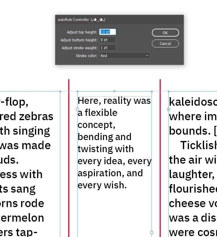

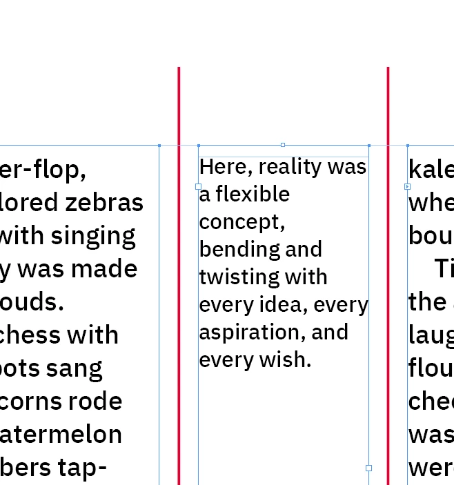

below is most of the code which can magically add rules to columns and frames of differenent lengths.
there is a controller code which sets values the user puts in and then creates and xml
and then there is the main code which can also use these xml values
the purpose behind both scripts is the user can use the main script via shortcut with no dialogue box
the controller script is working - and writes to xml file fine
but the main script doesnt seem to be able to get the right values for adjust top height or adjust bottom height
it always over does it by either adding more is the user entered a positive value or takeing away too much if the user ended a negitive value
Please may someone have a look as to what is making the main script not be able to read the controller script correctly
I have added the code below including the xml which is set up for adjust top height by 10 pt
Then the same result should happen when you run the main script which is suppose to read the values of the controller  -but it doesnt - it gives me this - much taller
The code is here

    var d = app.dialogs.add({ name: "autoRule Controller  (。◕‿◕。)", canCancel: true });
    with (d.dialogColumns.add()) {
        staticTexts.add({ staticLabel: "Adjust top height:" });
        staticTexts.add({ staticLabel: "Adjust bottom height:" });
        staticTexts.add({ staticLabel: "Adjust stroke weight:" });
        staticTexts.add({ staticLabel: "Stroke color:" });
        t = measurementEditboxes.add({ editUnits: MeasurementUnits.POINTS, editValue: tv, minWidth: 50 });
        b = measurementEditboxes.add({ editUnits: MeasurementUnits.POINTS, editValue: bv, minWidth: 50 });
        s = measurementEditboxes.add({ editUnits: MeasurementUnits.POINTS, editValue: sv, minWidth: 50 });
        cd = dropdowns.add({stringList:getArrayNames(app.activeDocument.swatches.everyItem().getElements()), selectedIndex:cv, minWidth:80});

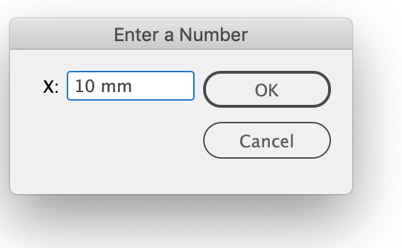

For exmple here the units are set to Millimeters with the starting value set to 10:
var x;
makeDialog();
function makeDialog(){
    var theDialog = app.dialogs.add({name:"Enter a Number", canCancel:true});
    with(theDialog.dialogColumns.add()){
        staticTexts.add({staticLabel:"X:"});
        x = measurementEditboxes.add({editUnits:MeasurementUnits.MILLIMETERS, editValue:10, minWidth:90});
    if(theDialog.show() == true){
        x = x.editValue;
        main()
        theDialog.destroy();
function main(){
    alert("Value Returned: " + x)

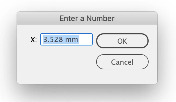

the initial dialog value is 3.528 mm (10 points)

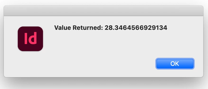

Set the value to 10 mm
and the returned value is 28.346566929134 points
rob day
August 26, 2023
The measurementEditboxes always return points even if the user specs some other unit, so your loaded XML numbers are points. You still have to either set the scripting measurement units or change the ruler units to points for the script without a dialog.
See editValue description here:
https://www.indesignjs.de/extendscriptAPI/indesign-latest/#MeasurementEditbox.html
