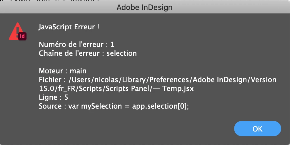

Hi everyone,
I'm facing a new problem with a script I was working on, it is supposed to read every cells I selected and let me apply a cell and paragraph style. It works fine unless my first selection is a merge row and the second one a row without any merge.
so selecting this two rows with this code makes indesign crash:
var mySelection = app.selection[0];
alert(mySelection.contents);
here's an example of my selection that crashes:
either it crashes, or it shows me once in a while that error:

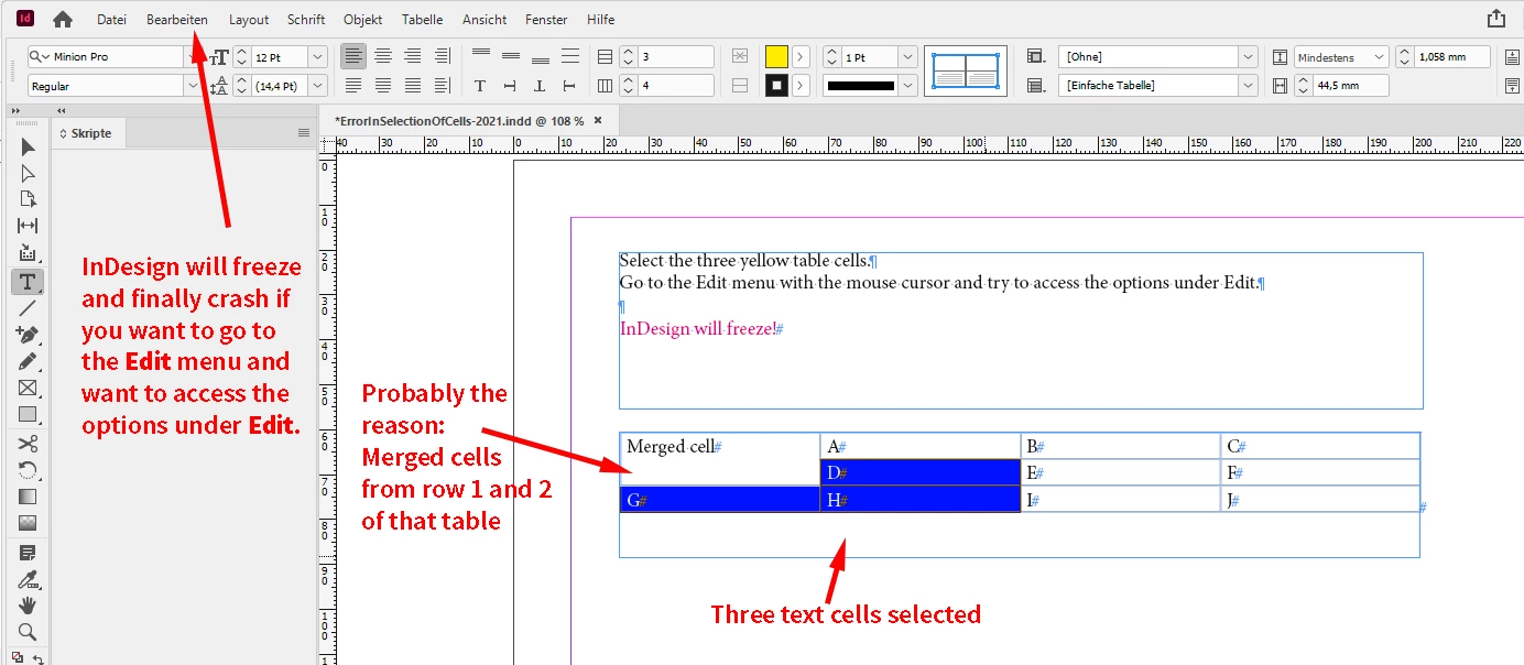

Jun 22, 2021 9:28 PM UTC
Well, I provoked the crash again. Before I prepared a bug report that I sent with the crash report also pointing to this discussion here. My test files can be downloaded from my Dropbox account:
https://www.dropbox.com/s/kafrbfebdf4765a/210622-1-AccessMenuEditWillCrashInDesign-3TableCellsSelected.zip?dl=1
A screenshot that illustrates the issue from my German InDesign 2021 version 16.2.1 on Windows 10:
Uwe Laubender
( ACP )
Jun 22, 2021 7:58 PM UTC
Hi Roberto,
well, I can replicate the bug with InDesign 2021 version 16.2.1 and yes, InDesign freezes when I tried to access the Edit menu with my mouse. I had to kill the application in my Task Manager for working on with my Windows 10 machine. No chance to switch to the open browser until I killed the InDesign application.
Uwe Laubender
( ACP )

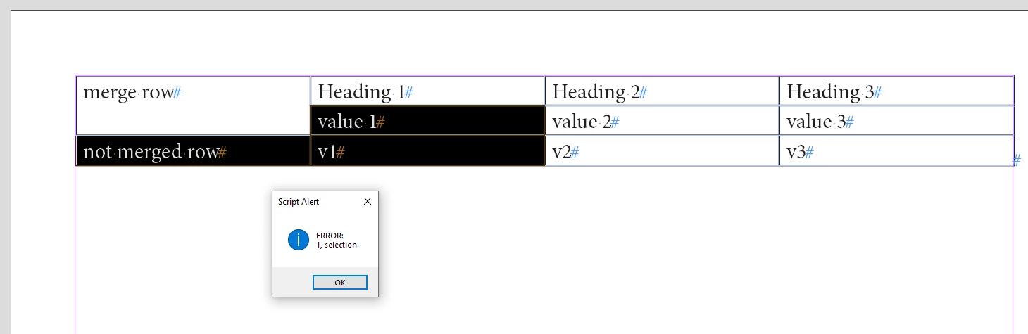

Sep 21, 2020 7:49 PM UTC
Even if I do a selection of the three cells by scripting the resulting selection throws an error.
// Text frame with table is selected:
var table = app.selection[0].tables[0] ;
// Let's do a selection of three cells:
app.select( table.columns[0].cells[1] );
// No error:
app.select( table.columns[1].cells[2] , SelectionOptions.ADD_TO );
// No error:
app.select( table.columns[1].cells[1] , SelectionOptions.ADD_TO );
// THROWS ERROR:
try
app.selection ;
}catch(e)
	$.writeln( "ERROR: " + e.number +", "+e.message ) ;
	alert( "ERROR: " +"\r"+ e.number +", "+e.message ) ;

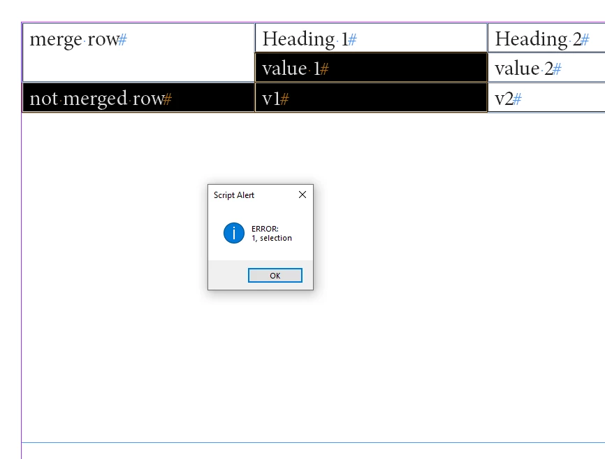

Sep 21, 2020 5:14 PM UTC
Also the following selection throws the error:
try
app.selection ;
}catch(e)
Uwe Laubender
( ACP )
