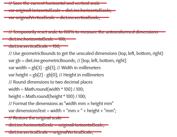

Robert at ID-Tasker
Nov 14, 2024 11:36 PM UTC
Try removing those lines from your code:
