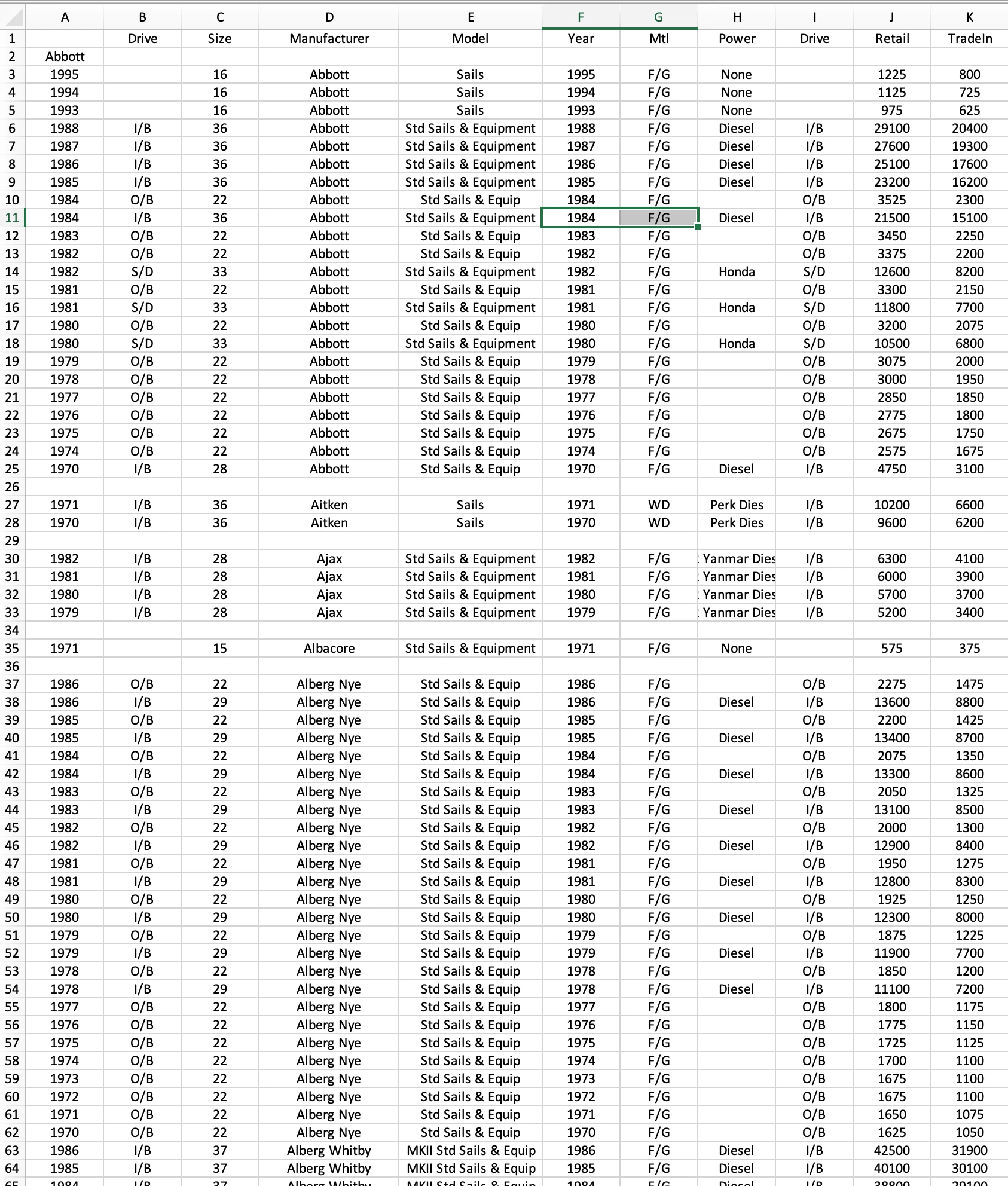

I'm trying to see if there's a way to script the following:
Adding a row above the first new Manufacturer and inserting the Manufacturer's name. For instance, I've manually added rows in above the for first few Manufacturers and copied and pasted the Manufacturer's name. I have thousands of rows to go through and was hoping to automate this if possible.
Any assistance is greatly appreciated.
Peter

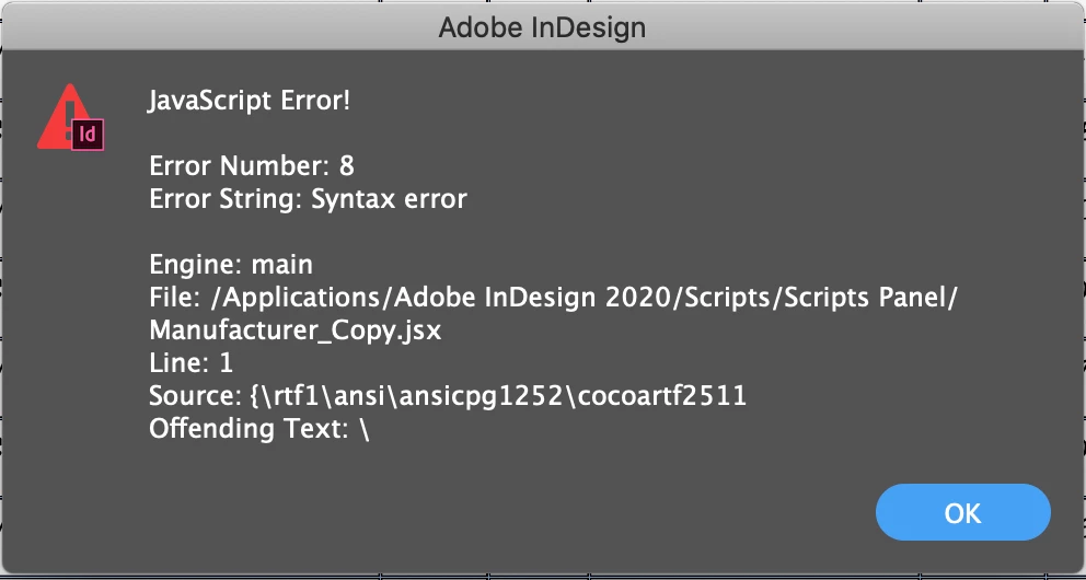

I appreciate the quick response and the script. When I ran it I got this error response and how I have the script setup:
var table = app.documents[0].stories.everyItem().tables[0];
var tableRows = table.rows.everyItem().getElements();
//get the model of the last row; ensure there are no blank rows at end of table
var matchStr = tableRows[tableRows.length-1].cells[3].contents;
//skip the first header row
for (var i = tableRows.length-1; i >=1; i--) {
     if (tableRows[i].cells[3].contents !== matchStr) {
           table.rows.add(LocationOptions.AFTER, tableRows[i]);
           tableRows[i+1].cells[0].contents = matchStr;
           matchStr = tableRows[i].cells[3].contents;
brian_p_dts
December 9, 2019
Hmm, check the .jsx file to ensure you didn't copy that "{\rtf\..." path into it? What you copied should be exactly what's in the script. Are you using a different script to call this script, or have other startup scripts at play?
