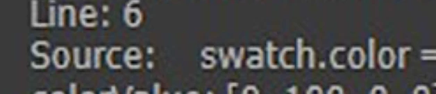

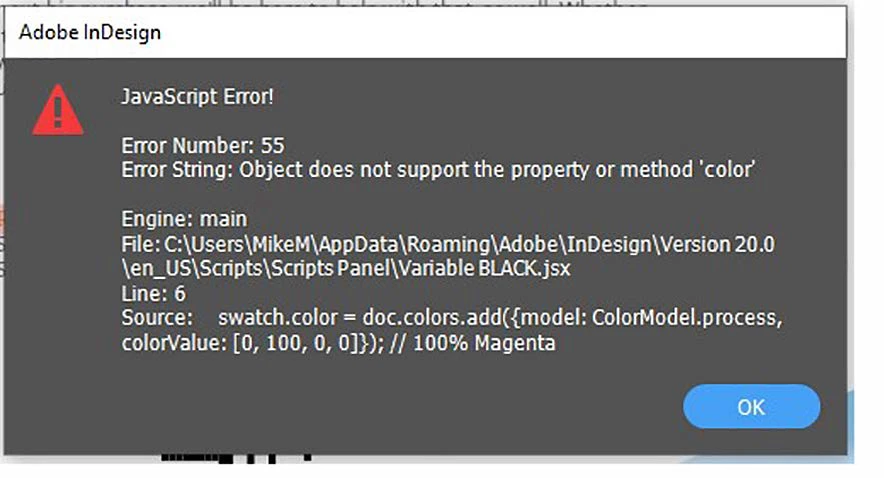

I have another script that I tried to call out the swatch name but I keep getting this error
var doc = app.activeDocument;
var swatchName = "VARIABLES100K";
if (doc.swatches.itemByName(swatchName).isValid) {
    var swatch = doc.swatches.itemByName(swatchName);
    swatch.color = doc.colors.add({model: ColorModel.process, colorValue: [0, 100, 0, 0]}); // 100% Magenta
Hi @WCMProduction , Is this what you are trying to do? Looks like you want to change the values of a color that already exists?
    swatch.properties = {model: ColorModel.process, space: ColorSpace.CMYK, colorValue: [0, 100, 0, 0]}
    //swatch.color = doc.colors.add({model: ColorModel.process, colorValue: [0, 100, 0, 0]}); // 100% Magenta

WCMProduction
May 8, 2025 6:37 PM UTC
AWESOME!!!!!!!!!! Rob! that worked perfictly Thanks so much!
leo.r
May 8, 2025 5:12 PM UTC
Before getting deeper into your script:
As the error message says, swatch doesn't have the color property.
