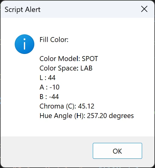

Looking for a way to work around InDesign limited color management capability.
Suppose I have some object selected on the page, the script would have to be able to extract the CIE Lab values out of the selected object, convert to Chroma and Hue angle, and paste the values in a new text frame. Doable? Easily?
Correct answer Roger Breton
Well, here's a simple script that displays an alert with the CIE Chroma and CIE Hue angle information.
InDesign HSB is useless because it is based on RGB.
I am not by any means a JavaScript specialist.
The code is quite simple:

Roger Breton
Roger BretonAuthorCorrect answer
March 19, 2024

        alert("Fill Color:\n\n" +
              "Color Model: " + fillModel + "\n" +
              "Color Space: " + fillColorSpace + "\n" +
              "L : " + l_value.toFixed(2) + "\n" +
              "A : " + a_value.toFixed(2) + "\n" +
              "B : " + b_value.toFixed(2) + "\n" +
              "Chroma : " + chroma.toFixed(2) + "\n" +
              "Hue Angle : " + hue_degrees.toFixed(2) + " degrees");
