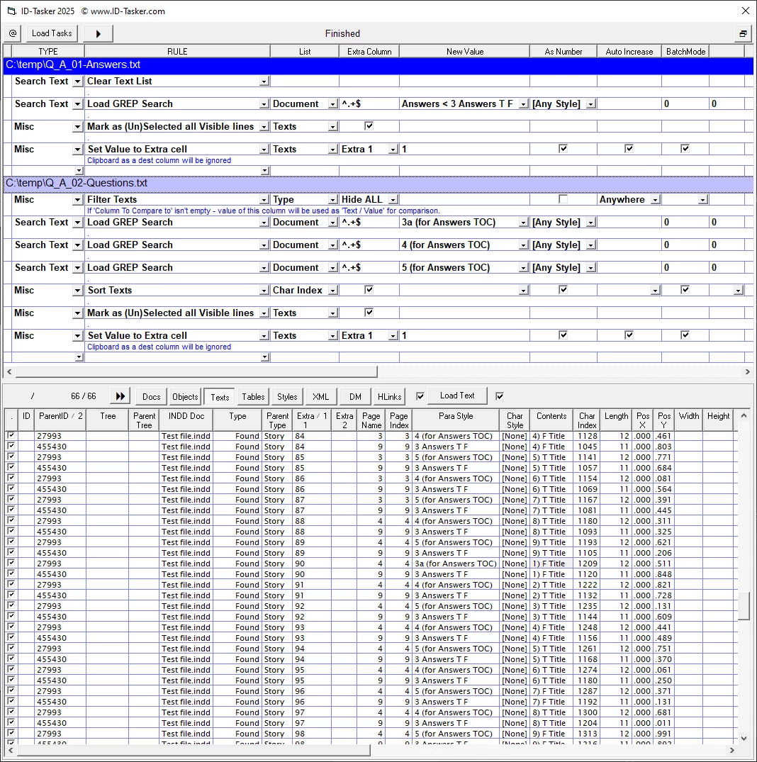

@marko_5038
Almost done:
(I had to create few extra rules)
My tool isn't free, but I can either give you access to the full version for some time - or you can send me your final file and I'll convert it for you for free.
Do you want hyperlinks from 1st part - Questions - point to the corresponding page in Answers - or to specific text / paragraph in Answers?
