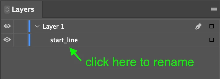

Hi @Joaquin35467744k2vs here's a script that should be useful in your situation. There are instructions in the script documentation below.
- Mark
Notes:
  • You must name the start item "start_" then something to identify it (because you may have multiple interpolations in the same document). For example: "start_fore_edge_marker".
  • the "end_" item cannot be on the same page as the "start_" item.

 * Instructions:
 *   1. create a page item (can be a Group)
 *   2. position the item on the starting page,
 *      in the starting position
 *   3. in the layers panel, name the item "start_"
 *      + an identifier of your choice, eg. "start_line"
 *   4. copy the item and paste it on the ending page,
 *      and move to the ending position
 *   5. name the pasted item "end_" with the same
 *      identifier, eg. "end_line"
 *   6. select the start or end item and run script;
 *      will create duplicates called eg. "middle_line"
