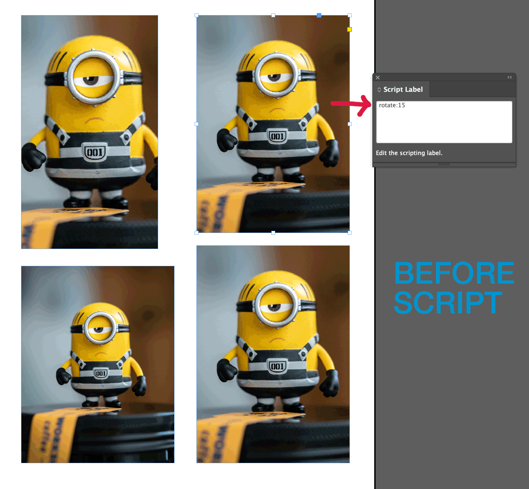

Hi @r28071715i111, here's an idea (and a working script). First you select each graphic (can be the graphic or it's frame) and set its Script Label (see the Script Label panel under Windows > Utilities menu) to "rotate: 15" where the 15 means 15 degrees counterclockwise. Will that work in your case? Script is below, and I've attached a demo .indd also so you can test script with that first.
- Mark
 * Apply rotation to graphics with a "rotate" script label.
 * eg. if label is "rotate: 15", then the graphic will be
 * rotated by 15° counter-clockwise.
 * @author m1b
 * @discussion https://community.adobe.com/t5/indesign-discussions/script-to-rotate-selected-image-inside-frame-data-merge/m-p/13955151
function main() {
    var doc = app.activeDocument,
        tm = app.transformationMatrices.add({ counterclockwiseRotationAngle: 0 }),
        images = doc.allGraphics,
        matcher = /^rotate:(-?\d+\.?\d*)/i,
        label,
        value;
    for (var i = 0; i < images.length; i++) {
        label = images[i].label || images[i].parent.label;
        if (!label)
            continue;
        value = label.match(matcher);
        if (!value
            || value.length < 2
            || isNaN(value = Number(value[1]))
            continue;
        images[i].transform(
            CoordinateSpaces.pasteboardCoordinates,
            AnchorPoint.centerAnchor,
            tm.rotateMatrix(-images[i].absoluteRotationAngle + value),
app.doScript(main, ScriptLanguage.JAVASCRIPT, undefined, UndoModes.ENTIRE_SCRIPT, 'Rotate Graphics');

But I have a question : Is that script work after making data merge or before ?
Ex : I want all images across pages in graphic frame 1 rotate by 10 degress
                  all images across pages in graphic frame 2 rotate by 23 degress
And so on
I will try your script and tell you result
Thanks for your effort in advance
m1b
m1bCommunity ExpertCorrect answer
July 23, 2023
Hi @r28071715i111, my idea was that you set up the script labels before datamerge and then run script after datamerge.
