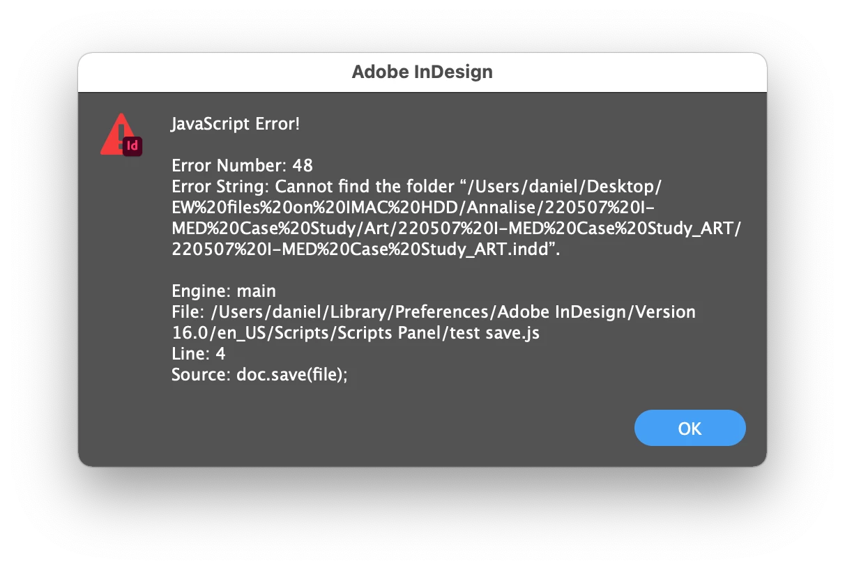

No sorry I hadn't.  I'm not very knowledgeable with code.
It seems like it has issues if the folder has spaces in it I think since I get the below error message.
I tested on an indesign document placed on the desktop and it ran without giving me the error. However, it created a copy on the desktop and replaced the spaces in the filename with %s.
Hello @danielw42205661,
Give this a try, it will save over the open document when you execute the script even if no changes were made ...
doc = app.documents[0];
myDocFolder = doc.filePath;
doc.save(File(myDocFolder.fsName + "/" + doc.name));
Mike

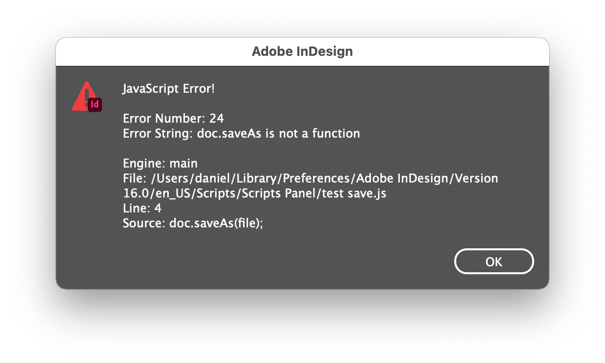

Try the following
// app.userInteractionLevel = UserInteractionLevel.DONTDISPLAYALERTS;
var doc = app.activeDocument;
var file = File(Folder.desktop + '/test.ai');
doc.saveAs(file);
// app.userInteractionLevel = UserInteractionLevel.DISPLAYALERTS;
I run it multiple times on same document, and it does not show any alert that file already exists. You can try and let us know if that works for you.

Thanks for your reply.
When I try to run the script I get the error below. Do you know what I would be doing wrong?

My mistake. I have written that for Illustrator.
