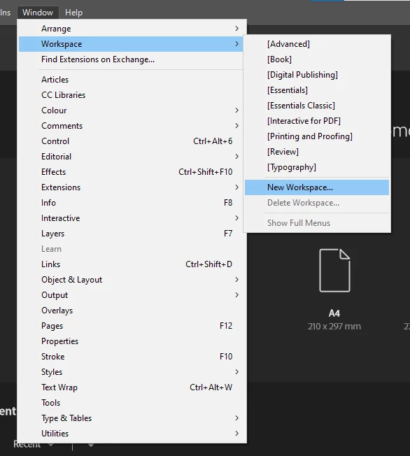

Hi gang,
I cannot find a script that shows specific panels in the dock. Does anyone have an example of script that shows/calls forth a named panel into the dock? Or even a script line that calls forth into view a panel in the middle of the screen floating free?

Hi Robert and Rob,
Thanks for the assist. Rob, your script works for showing one panel, but when I duplicated it by 14 panels I wanted to show, it didn't work. I'm trying to show 14 of my favorite every-day panels, make them show up in a dock, and have it save the workspace as "IDclass".

Robert at ID-Tasker
January 20, 2024
@Mike Witherell
As @Nick Passmore suggested - you need to refer to Panels collection - not menu:
var myPanel = app.panels.item("$ID/Info Panel");
myPanel.visible = true;
