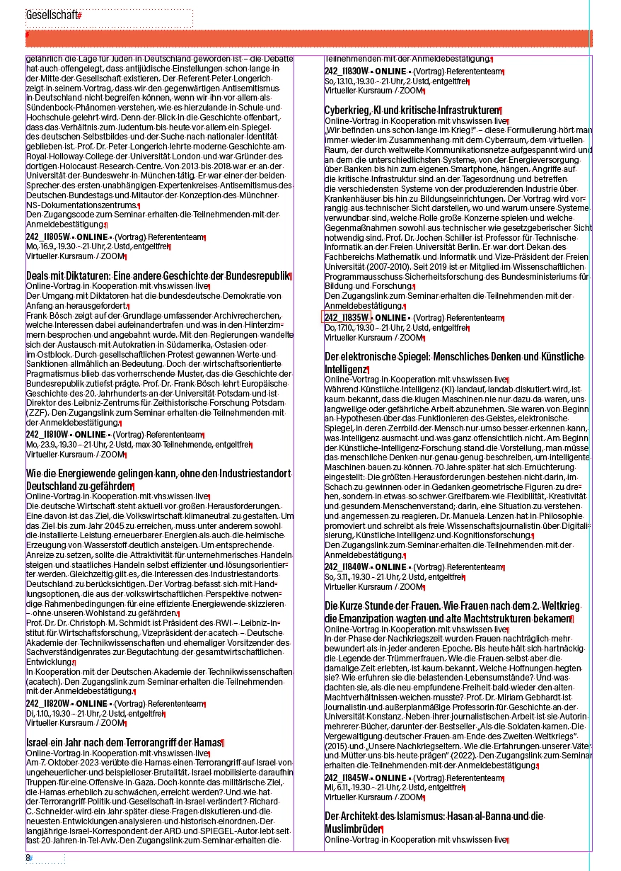

Can you post a screenshot from InDesign - with hidden characters visible.
And the paragraph with the number is in the middle of the block to be moved, right?
June 26, 2024
yes the number is located after the description of the course
