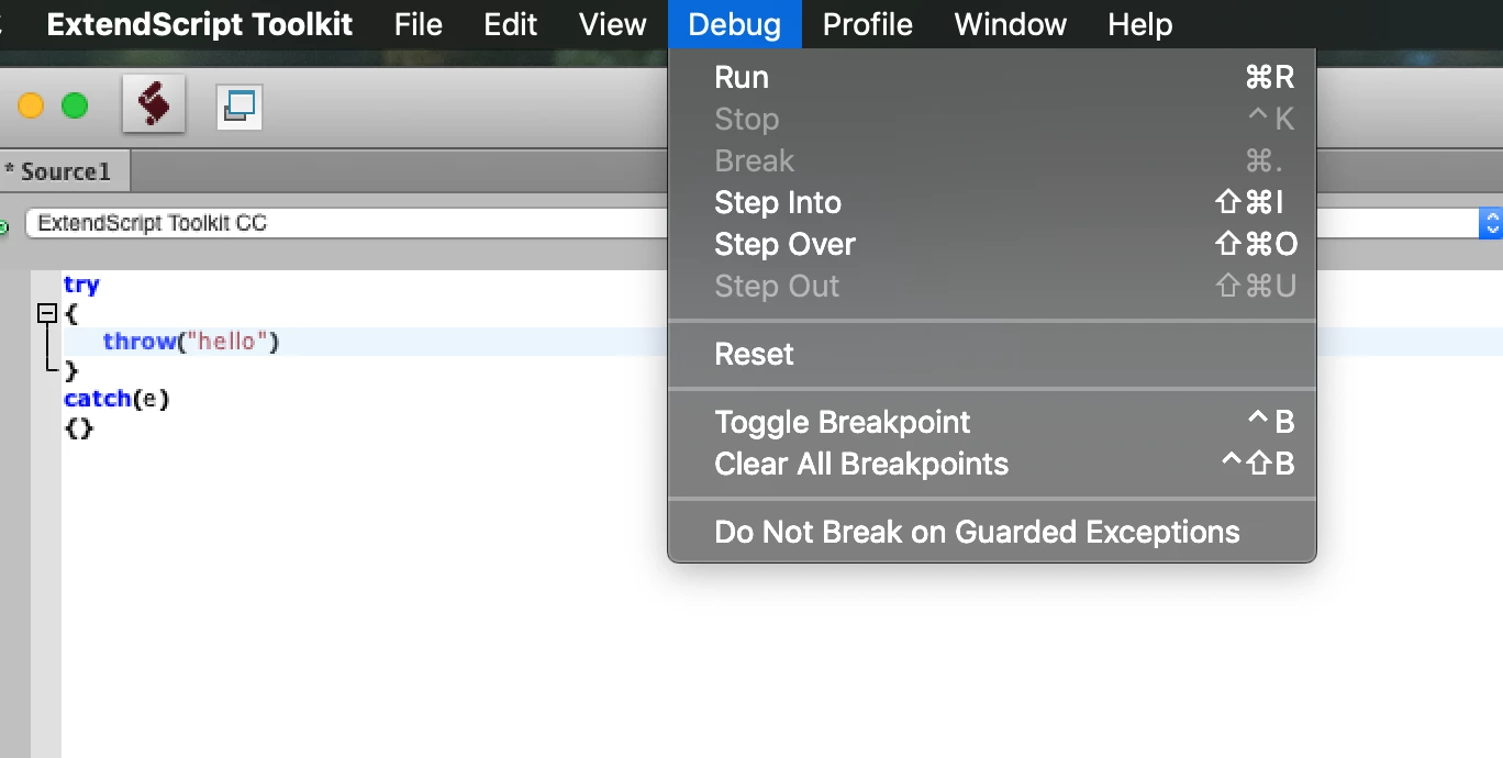

Manan JoshiCorrect answer
Sep 18, 2020 4:31 AM UTC
There is an option to toggle this behavior in ESTK. See the screenshot
You need to have the option "Do Not Break On Guarded Expection" as on and it should be fine.

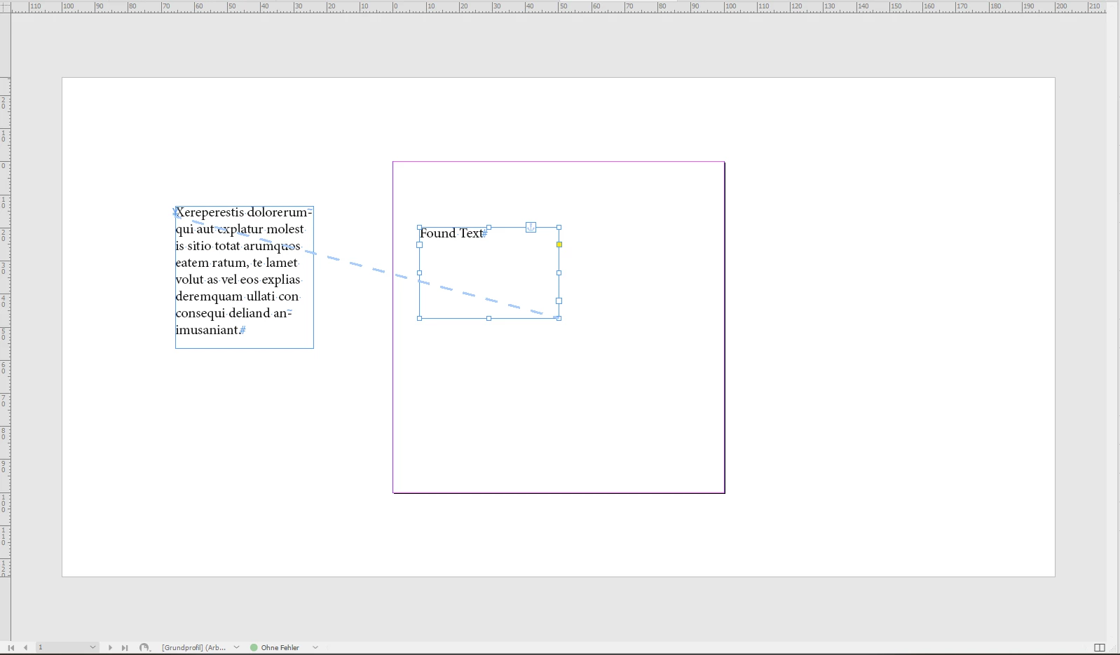

Hi lf_corullon,
note, that there are also "special" cases where parentPage returns a page object, but the object is not part of the page.
In this case the text frame cannot be found in page.allPageItems, but only in spread.allPageItems.
Here an example of such a special case:
var foundPage = app.selection[0].parentPage ; // returns: [object Page]
foundPage.pageItems.length // returns: 0

Manan JoshiCommunity ExpertCorrect answer
