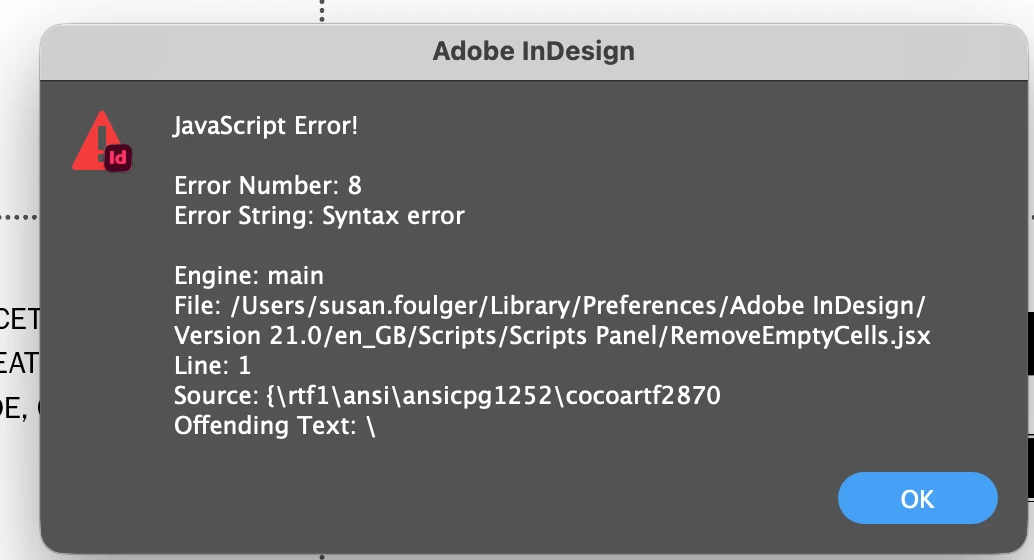

I am using a data merge for a brochure I am working on. In the brochure there are tables, I would like to remove any cells which are empty by using a script. I have found several online and added them into the script folder (not all at the same time), however I get an error every time. Can anyone help - please?

    Looking at the error it seems you have not saved the script properly and it is saved as an Rtf document. Try the following code

    Follow https://creativepro.com/how-to-install-a-script-in-indesign-that-you-found-in-a-forum-or-blog-post/ article to properly save the script and execute it. Maybe that is all you need with your current script

    So what was it? Was it a problem with the saving of your script or did you need the code that I gave?
    -Manan
    Jun 26, 2026 7:45 AM UTC
    In TextEdit, I formatted as Plain text. Saved it as txt file and then renamed to .jsx and it worked. It was the saving of the script. Thank you for your help

    This is the error I receive
    Manan JoshiCommunity ExpertCorrect answer
    Jun 25, 2026 11:53 AM UTC
