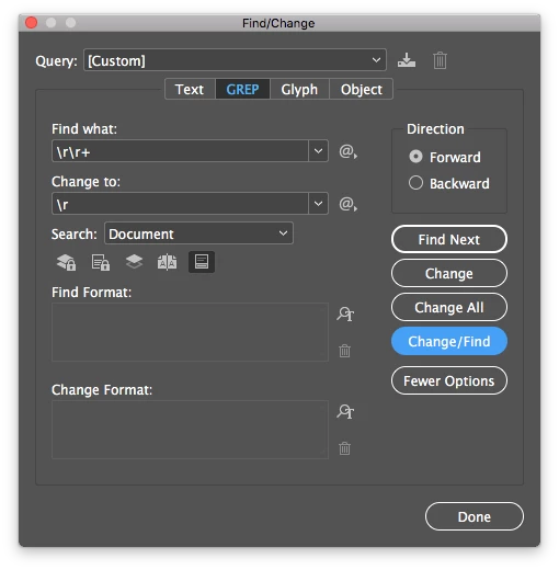

On a Mac you can use the space bar as you get into this screen, having used the "change/find" button once with the mouse:
Then keep hitting the space bar to do the job. If you want to skip a replacement, just press the Cmd+Opt+F to "Find Next" and get back to the space bar. It worked fine for me.
(Naturally, actual shortcuts are missing. TextWrangler/BBEdit has shortcuts for all of these actions. Cmd+= replaces once and Cmd+opt+= replaces all, for instance)

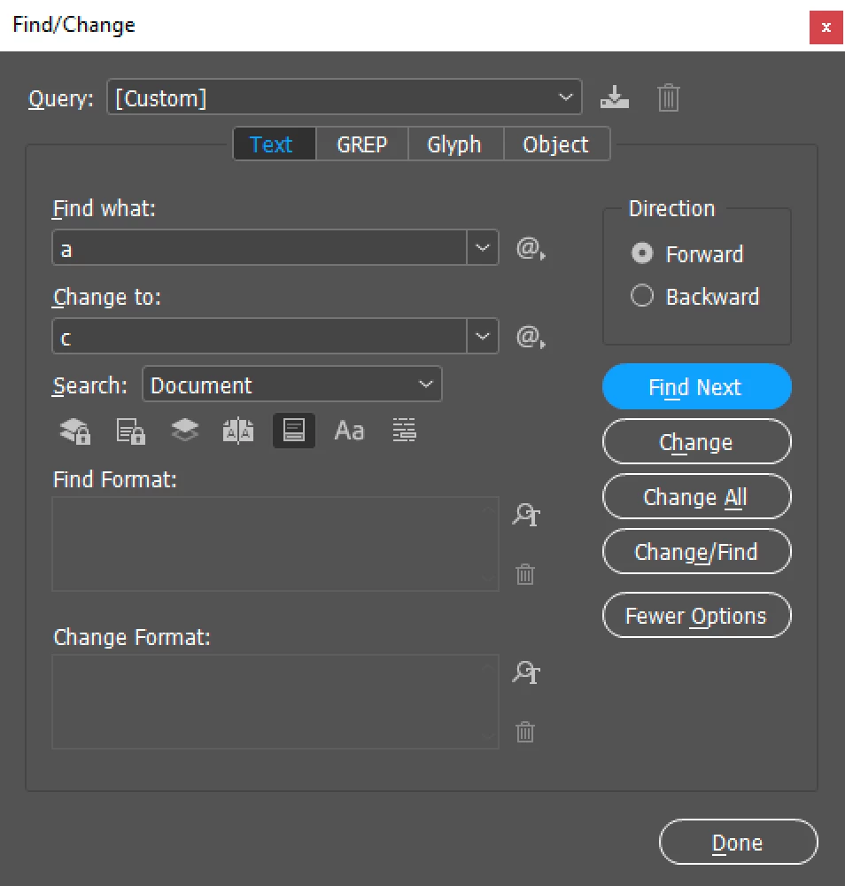

Hi Csmoke:
Are you on a Mac or Windows workstation? Windows offers keyboard shortcuts for just about everything, including the buttons you mentioned in Find/Change.
Tap Alt to expose the keys needed to activate buttons (note the underlines in the screen shot below). Alt+n is Find Next, Alt+h is Change, Alt+a is Change All, etc. Unfortunately, I don't know of a Mac equivalent.
