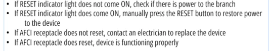

Hey there.  Newbie here.  I haven't been in Indesign for 6 months.  I am creating a bulleted list using a pragraph style.  I used to hit (I think) Ctrl \ to get the second line of a bullet to line up with the text on the first line.  When I am doing it now, it indents the second line but way too far to the right.
Chris1868Correct answer
Jan 23, 2013 3:44 PM UTC
Here is an image to further show what Peter is talking about.

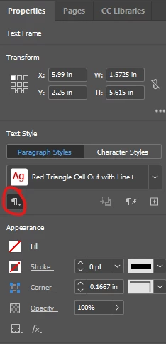

Posting for furture people having trouble with this cause the people were confusing in this thread but I did manage to make sense of it.
First you need to make your left indent a positve value (I cicked up arrow once),
then you can make your first line indent an equal negative value, and after that they should show up correctly.
If you are having trouble finding this menu, open the properties panel and find the paragraph icon (circled) and click “Style options...”

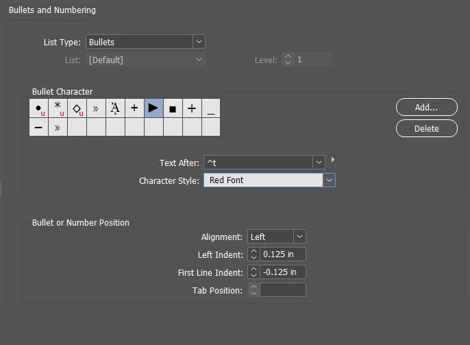

I need help as well. I have a bulleted list inside a table and the second linne of the second bullet has an extra indent.
I have the left indent and first line indent opposing each other mathmatically. It still isnt working. This software would greatly benefit from what Apple did with Logic., as to where it has a help button and whatever you hover your mouse over, it explains what the object is and how it works. Too many times am I lost in inDesign due to how specifically it works. Its not intuitive at all.
It would make sens that if I have a bulleted list and I dont add hard return, the next line would line up. This is bonkers to me. When would I ever need my second line of text to do this, if its apart of the previous sentence?
Here is the example. Notice my second bullet point. It is inside a table and I have no idea how to make it behave.

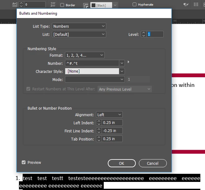

I'm having the same issue (trying to get the second line of a numbered section to start with the text of the line above). Adjusting the settings to match the ones above doesn't seem to fix it.
Dec 3, 2018 8:57 AM UTC
Increase the value for left indent a bit and set first line indent and tab position accordingly.
