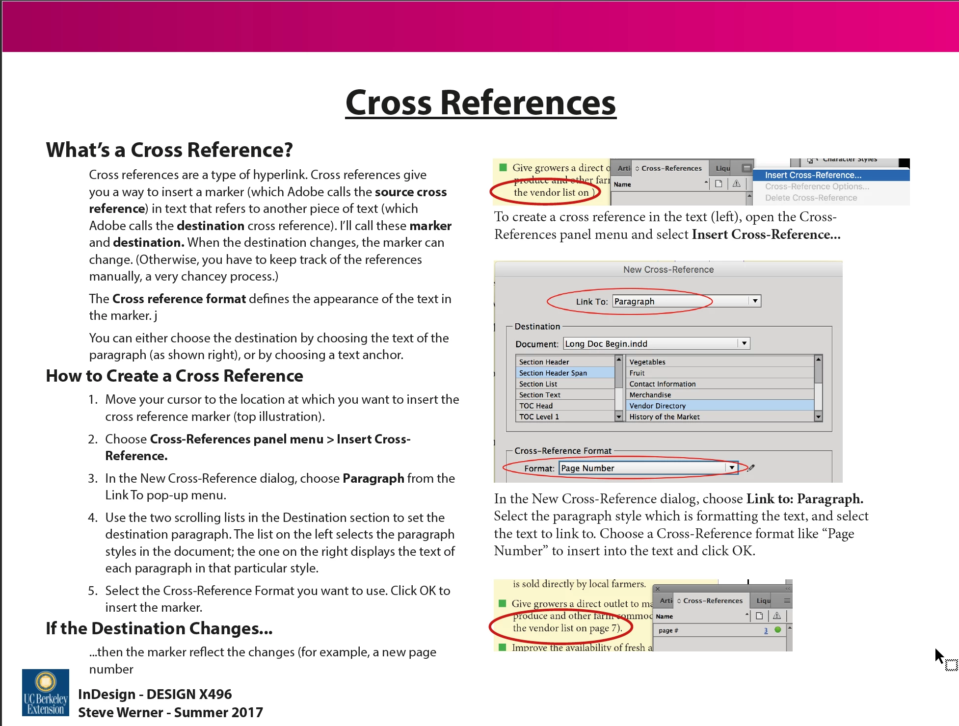

    Steve Werner
    September 2, 2017
    What are you seeing? Can you attach a screen capture?
    I'm attaching a slide from an InDesign course I teach which explains it visually. See if this helps:
