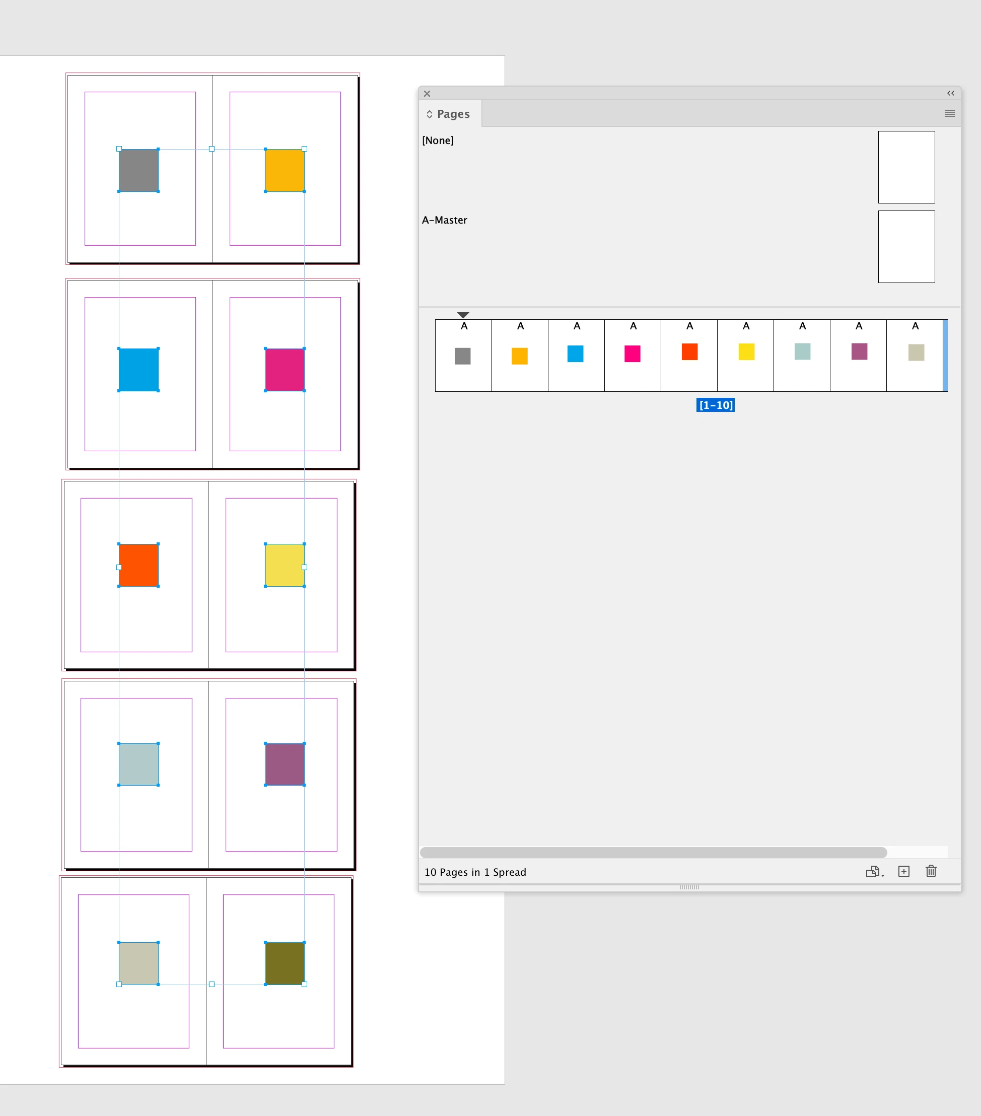

In a 4-page InDesign file you cannot select objects on all four pages?
A document setup with Facing Pages turned off can have spreads of up to 10 pages which can be arranged in any way with the Pages tool—in that case the pages’s objects can be selected:
Geоrge
May 5, 2022 3:05 PM UTC
This is not "full" feature and neeeds to rearrange pages. However - thanks.
