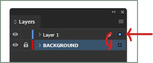

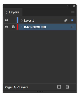

If you are going to use a background element (a rectangle) to form a background color, it has to be at the very back of all page elements, especially all layers. It sounds as if maybe you have your rectangle grouped with something that remains behind it no matter how you change the stacking order within that 'group' of items.
The optimal way to do this is to create a new Layer and place the background object within it, then move that Layer (best named something like BG or Background to minimize confusion) to the very bottom of the stack in the Layers window. Once there, lock the layer so that you don't keep selecting or moving the background object.:

You can turn off and on most of the various grids, guides, etc. with indivdiual commands. It sounds as if you may have switched into preview mode, which turns them all off.
Under View | Screen Mode, select Normal. That should restore all the guides etc. (You can toggle between Normal and Preview by pressing W with nothing [text] selected on the screen. Very useful.)
To put your background rectangle in a layer by itself, select it, and then drag the teeny indicator square from its layer to your background layer:
