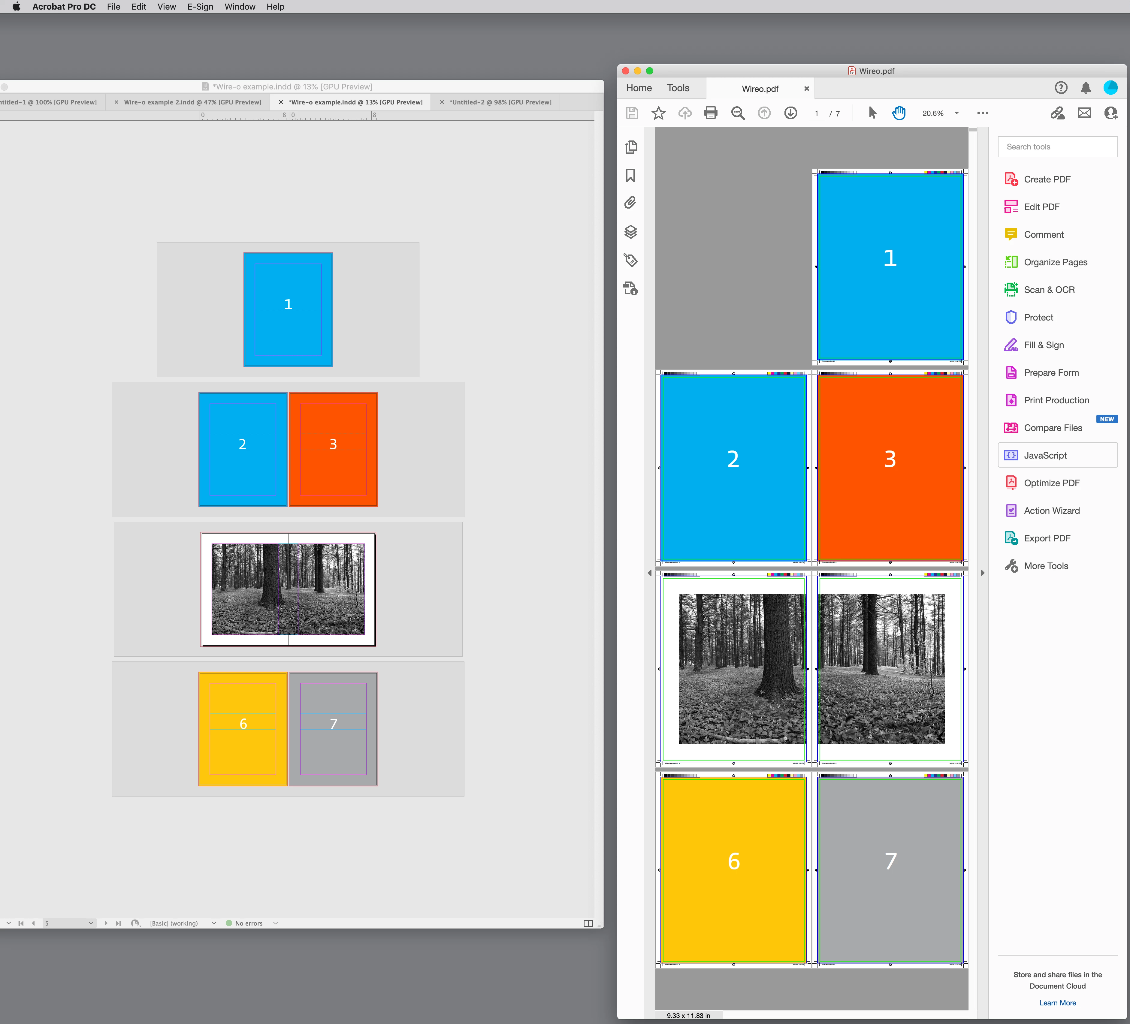

Apr 21, 2025 3:26 PM UTC
The separation must only move the right and left pages away from each other along the horizontal axis.
I leave an example image.
Hi @Alex32252670s8p0 , A document can be set up with Facing Pages unchecked in Document Setup, and then you can create Master Spreads as facing pages with any amount of space between the pages. This would be usefull for binding methods where the inside edge is trimmed and visable (e.i., Wire-O). You would not want to do it for bindings where the inside edge is folded and not trimmed (e.i., Saddle Stitch) because the printer would remove any bleed you provide during the page imposition before going to press. See attached.

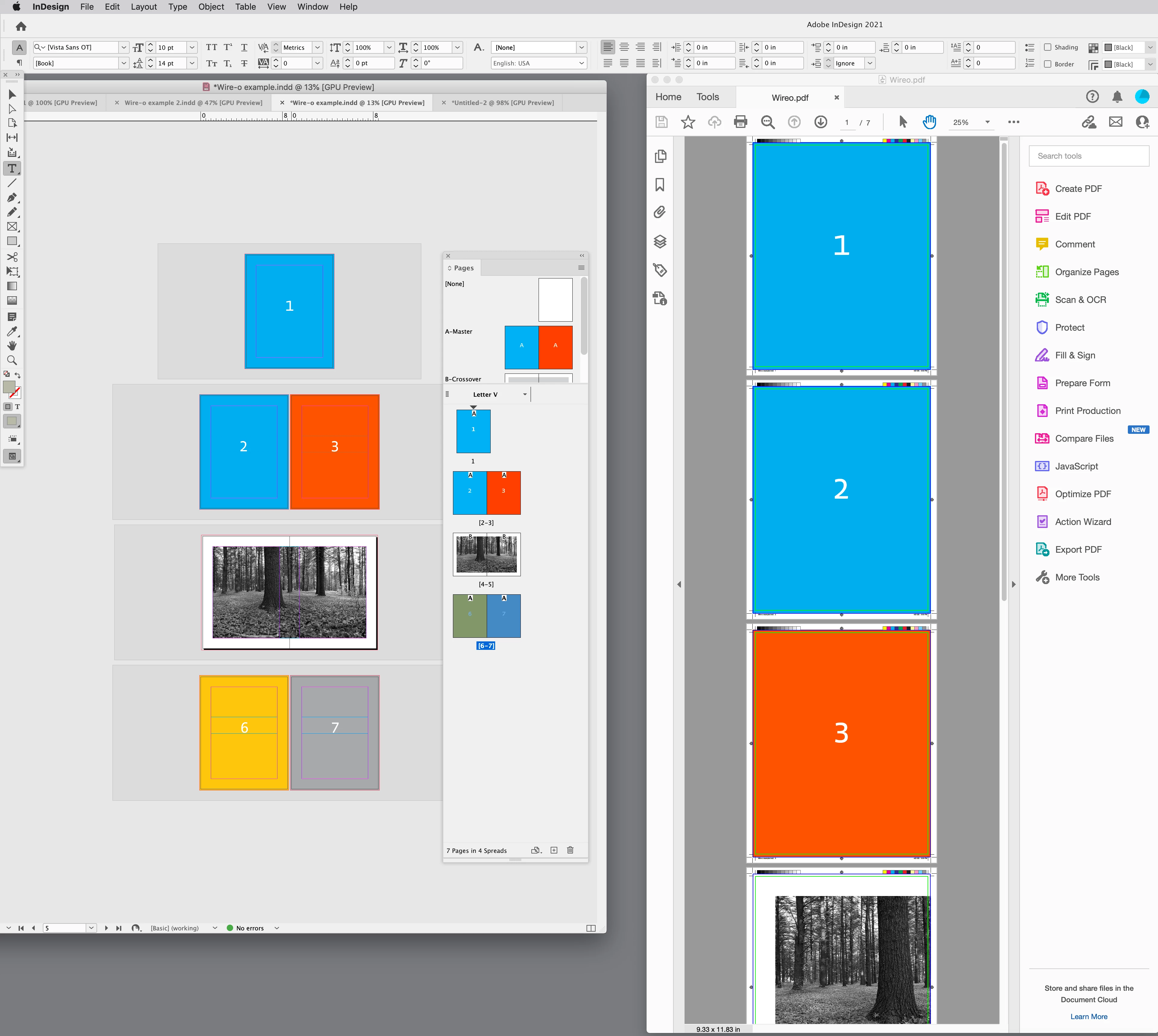

Apr 21, 2025 10:18 PM UTC
@rob day that's an interesting file, but Page 1 seems to be a left instead of a right.
Hi Peter, If your Document Setup has Facing Pages unchecked the pages get centered on the pasteboard and there is no spine guide. But that doesn’t matter because documents that will be imposed have to be Exported as single pages, not spreads. I downside of this approach is, the Align Towards/Away From Spine Paragraph setting doesn’t work automatically because there is no spine guide.
So a default PDF/X-4 with bleeds and marks Exports like this—single pages with bleeds on all sides:
Or if I turn on Page Display > Two Page Scrolling in Acrobate, the PDF dislays like this:
Peter Spier
