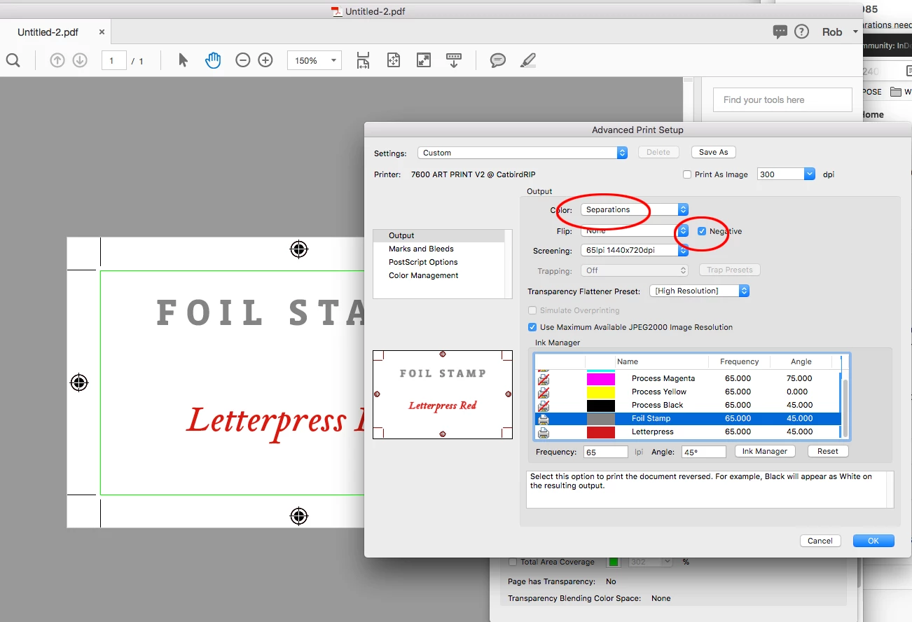

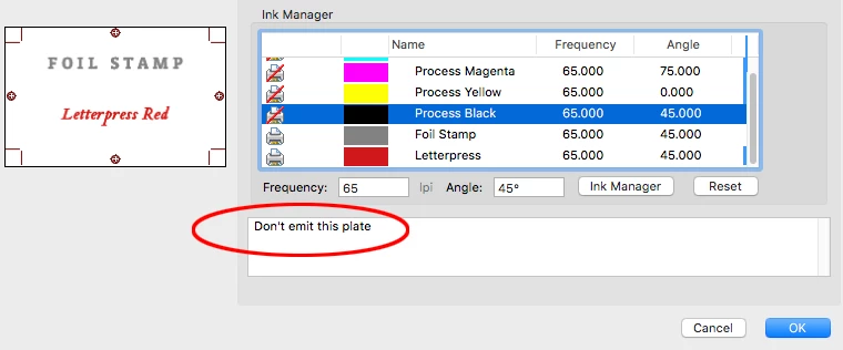

    From AcrobatPro's Print dialog you would choose Advanced then Separations as Color and check the Negative box. Click on the CMYK separations so they don't output. I'm assuming your RIP will let you choose Separations under Color—my example printer is a Postscript RIP

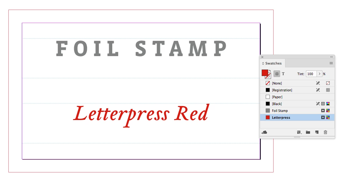

    So this InDesign doc uses two spot colors and has a 5mm bleed:

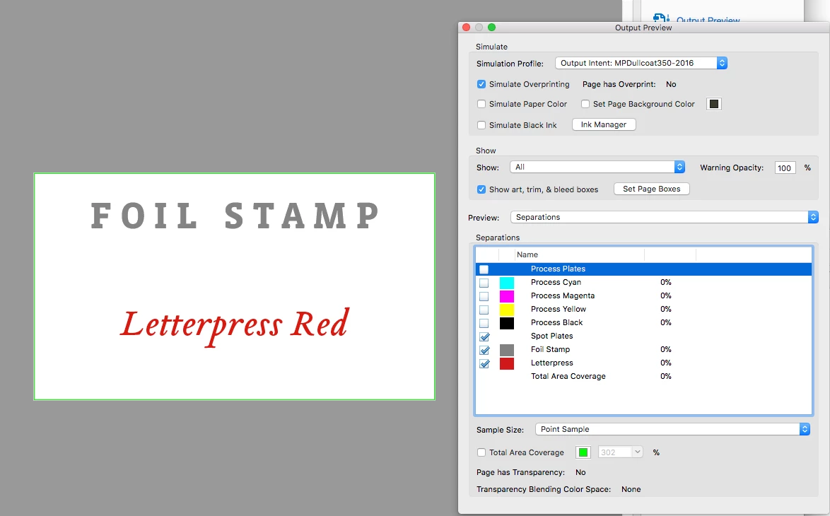

    I export it to PDF/X and the Output Preview shows the two spot separations:
    The Print>Advanced dialog set to print Negative Separations of the two spot plates:
