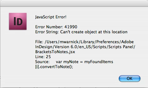

Thank you for the help. The script you provided set many of the brackets to notes, but half-way through I got the following error:
JavaScript Error!
Error Number: 41990
Error String: Can't create object at this location
File: /Users..../Brackets to notes.jsx
Line: 25
Source: var myNote = myFoundItems
.convertToNote();
It looks like it happened when it reached the end of the document. Does the cursor need to be at the beginning of the document for the script to work correctly?
I should have also mentioned I don't want set as notes brackets that begin a paragraph. For that reason I had put a single space at the beginning of my search string, though you probably could tell that from my initial post. Would it be very hard to change the code to fix those two issues?
