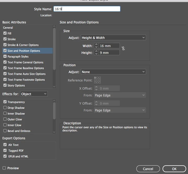

As you aluded to you can set this up in Photoshop - and if you do that and place it into indesign the way you want it - then it's that aspect ratio going forward.
You could setup an Object Style that uses those widths/heights and then scale your image to fit the frame.
You can also set your fitting options here too

Well I gave you the answer - you can have object styles, and set this up going forward, you could switch between different aspect ratios by choosing different object styles.
It does not work the same as photoshop - but you have 2 ways - do it in photoshop or do it in inDesign.
It should be fine.
