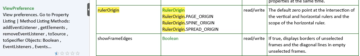

Robert at ID-Tasker
January 18, 2024
I think you also have to remember about RulerOrigin property:
