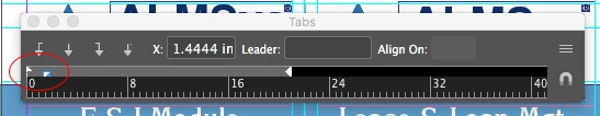

What is the secret to setting the indents? I have to click a dozen times or more to finally select the indent icons. If you miss ever so slightly InDesign sets a tab location.
Suggestion to Adobe either make the indent icon selection more selective, that is, there is a way to differentiate between setting a tab and selecting the indent icons or add a key selection to the operation, like Option + click. It's been like this since InDesign 3.

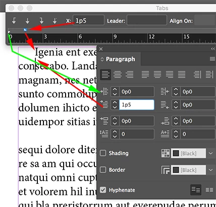

Just use the Paragraph controls in the controls panel or the Paragraph panel. You can use the Tab panel, Paragraph panel or Control panel with the paragraph Formatting controls in view.  (same icons as the Paragraph panel)
This shows the Tabs panel compared to the Paragraph panel. (Under Window>Type & Tables>Paragraph

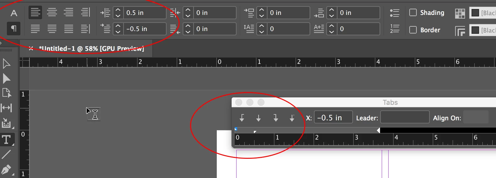

I find it much easier to set indents precisely and quickly on either the Control panel (Paragraph mode) or Paragraph panels. (Or in the Indents section of a paragraph style.)
It looks like you're setting up a hanging indent. On the Indents section of the Control or Paragraph panel, you want to set your Left indent value (for example, .5 in) and set the First Line indent to a negative amount of the same value (in this example, -.5 in.)
See the screen capture below which shows that the same effect appears both in the Tabs panel where you're trying to set it, and simultaneously in the Indents section of the Control panel:

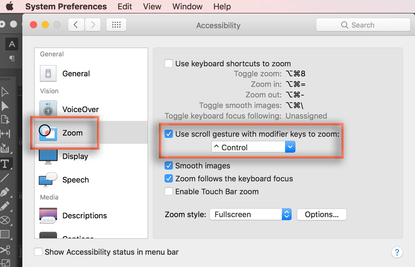

Here's the secret: just the very tip of the arrow must touch the indent triangle. On a Mac, if you can't see it well enough, set it up so that you can hold the Control key to zoom in. Once enabled, press and hold the Control key and drag two fingers up (to zoom in) or down (to zoom out). I use it all the time.
