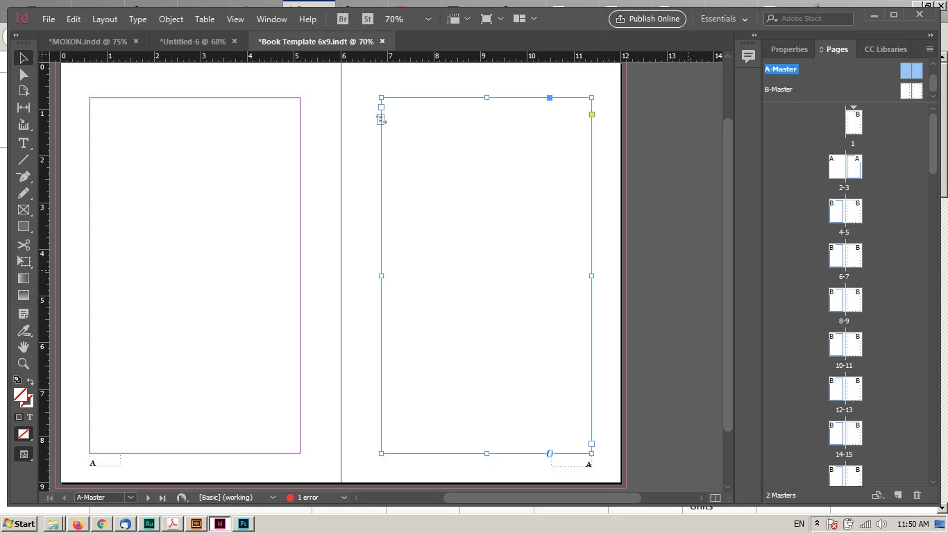

I have two master pages, Master A:
...and master B:

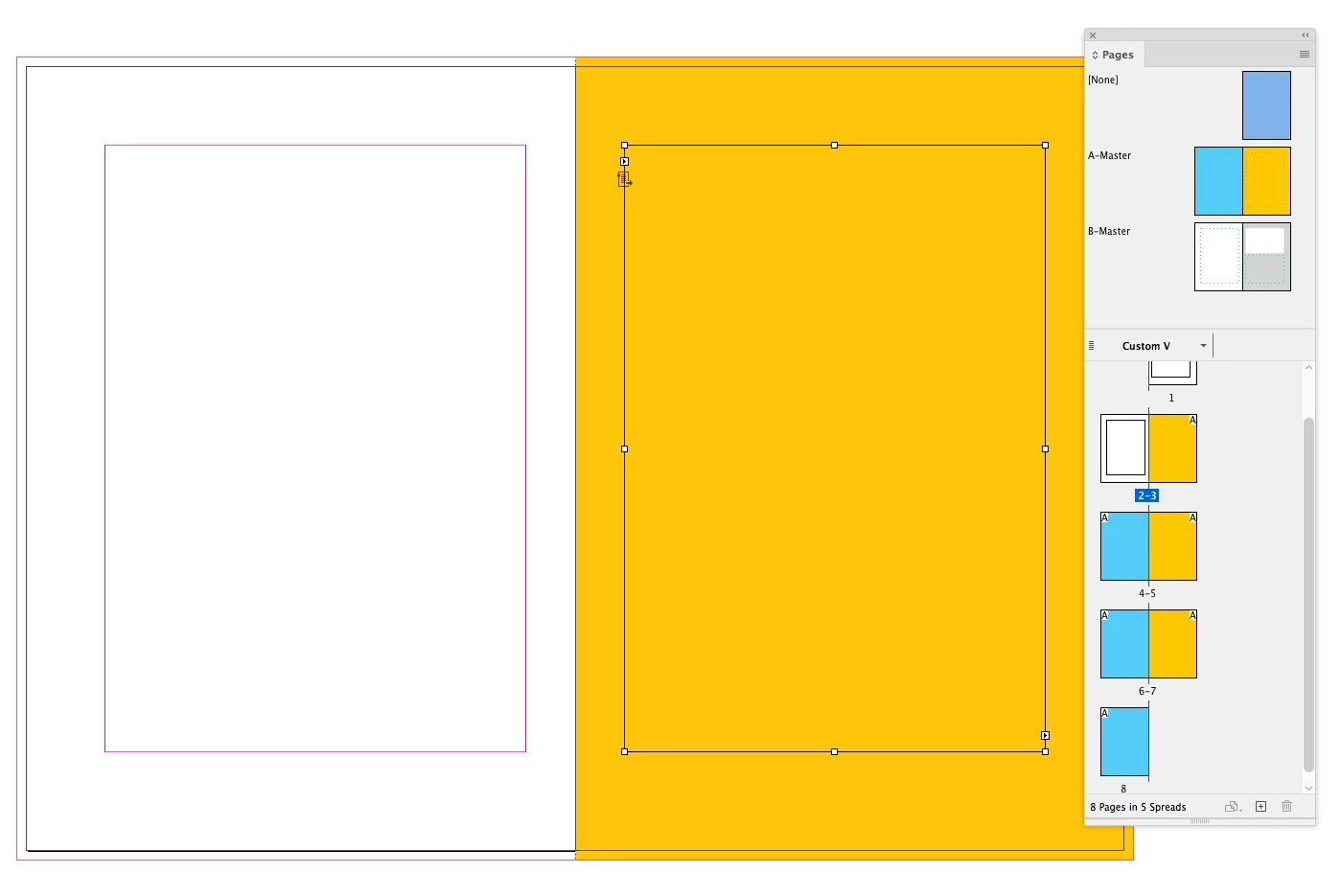

Ignoring page 1, page 2 is intended to have a picture placed on it and I want the story to start on page 3:
As you can see I've typed some random text into the frame and allowed it to overflow and hence I get the red triangle

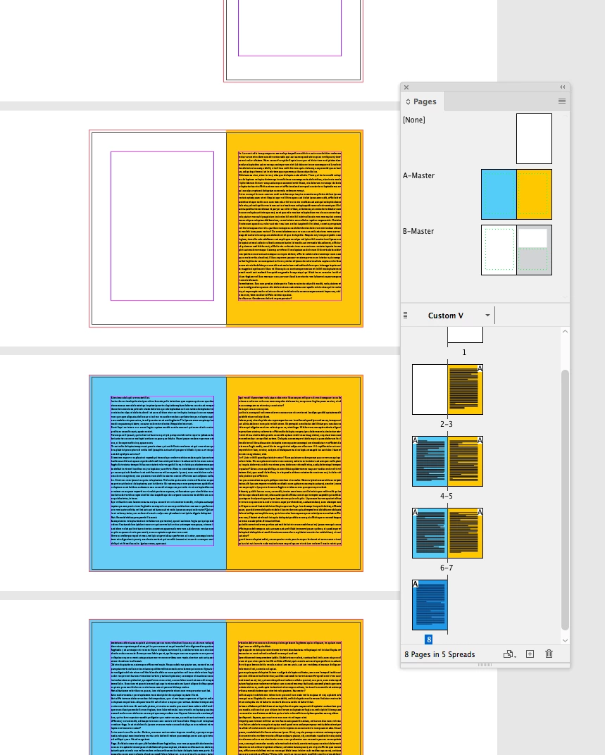

What I would like to happen is for the text to flow on to page 4 (which has master B applied) and then flow on to subsequent pages automatically.

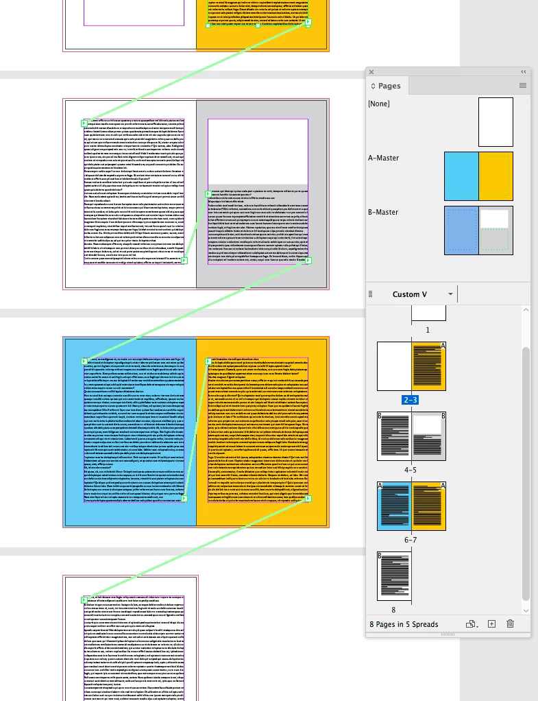

Correct answer rob day
Make sure both masters are using Primary text frames. Here I’ve set up the document with all A-Masters, and flowed the text from page 3 to 8. With thetext flow established I can drag the B-Master on to a page in the pages panel and convert that page to the B-Master without interupting the text flow
Dragging the B-Master on to the 4-5 spread

rob day
rob dayCommunity ExpertCorrect answer
February 11, 2020

Thanks for that, it all makes sense in theory. However, changing the frames to primary on all masters didn't quite do the trick for some reason - the text flow on page 3, corresponding to the right hand page of my master A still didn't seem to want to go anywhere.
What did work was this: I manually threaded page 3's text frame to left hand text frame page 4, then left hand frame to right hand frame on page 5, finally right hand frame page 5 to left hand frame page 6
Then i dragged pages 2 & 3 and 4 & 5 into the masters section, creating C and D masters.
I now have masters that i can apply to my document and the text flow works.
