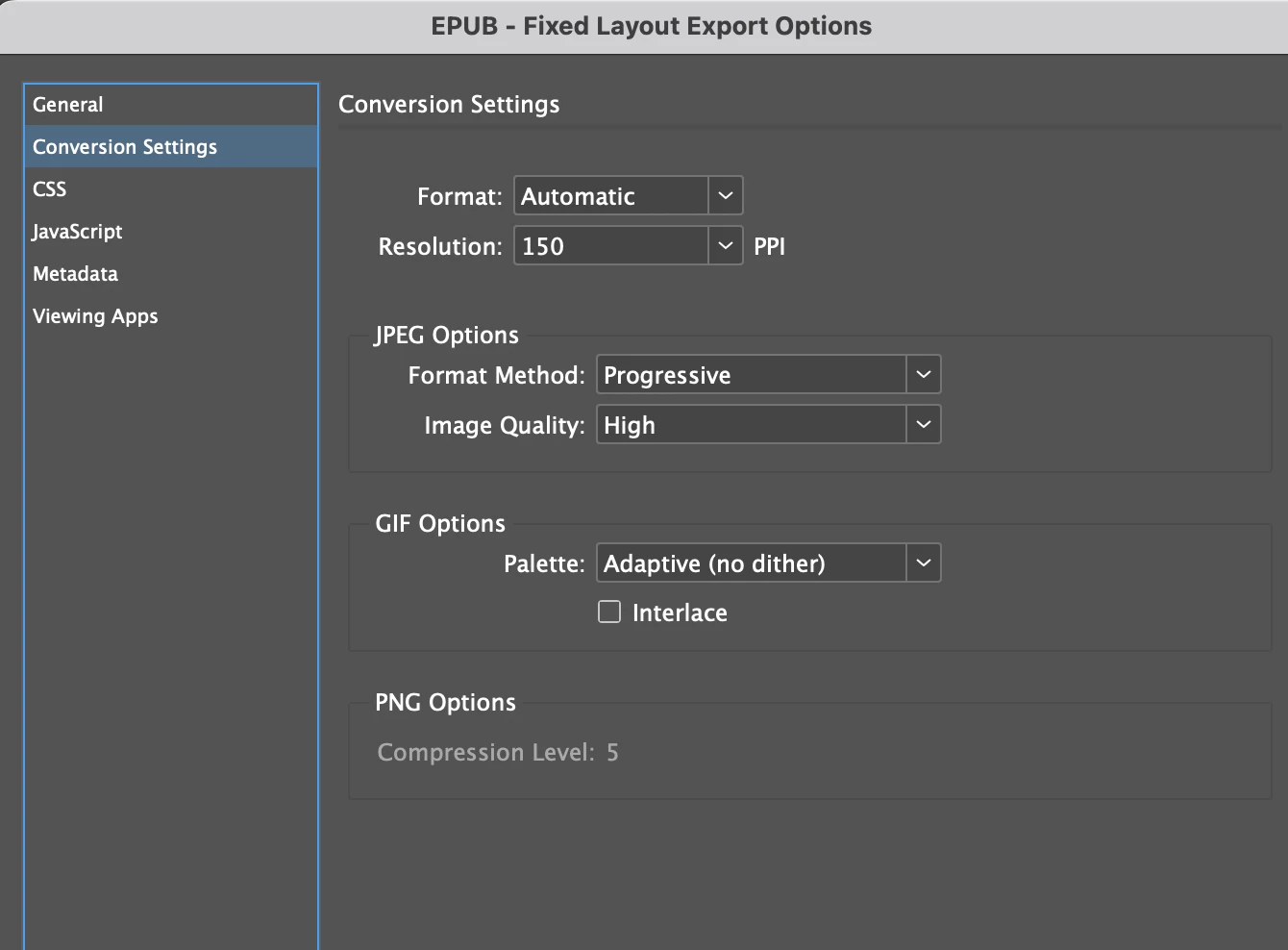

3. I'm exporting as a fixed pdf. I haven't really touched any of the default settings. No cover, no navigation.

One of the problems with FXL is that everything not text is converted to PNG graphics and each page is assembled more or less like a web page. That conversion is not often great. I'd suspect that your ID shapes are being converted to an intermediate form and acquiring the frames.
Set the export to PNG, not Automatic.

Specify PNG when exporting for graphics.

Aug 15, 2024 2:59 PM UTC
Not sure what you mean, BobLevine. These are not imported graphics, they are created in InDesign. I can't change the spec in the export screen.

Where it says Format: Automatic, change it to PNG.
