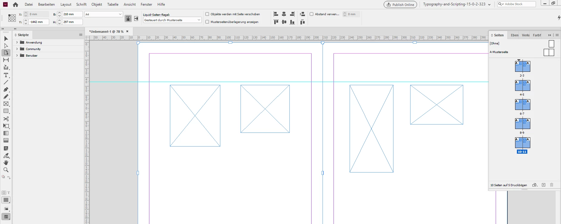

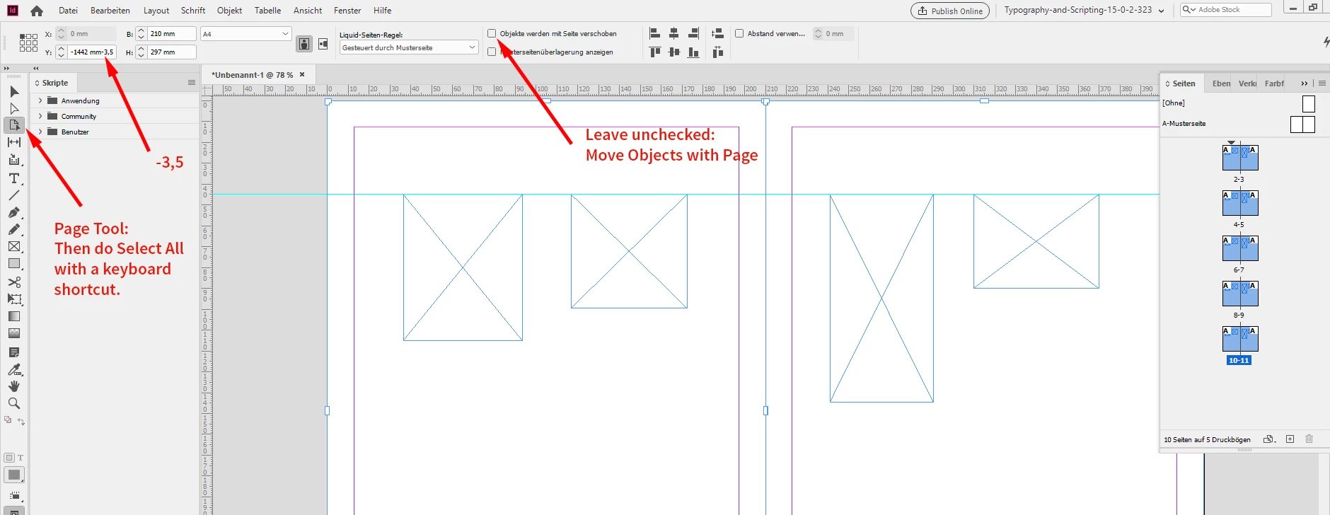

the fastest way to move everything on document pages down by e.g. 3.5 mm is to move the document pages up without moving objects with the pages. To select all pages switch to the Page Tool and do Select All with the keyboard shortcut. Then add -3.5 to the existing value in the input field of Y of the Control Panel.
From my German InDesign 2020 where the Control Panel is visible.
Result:
Result:
