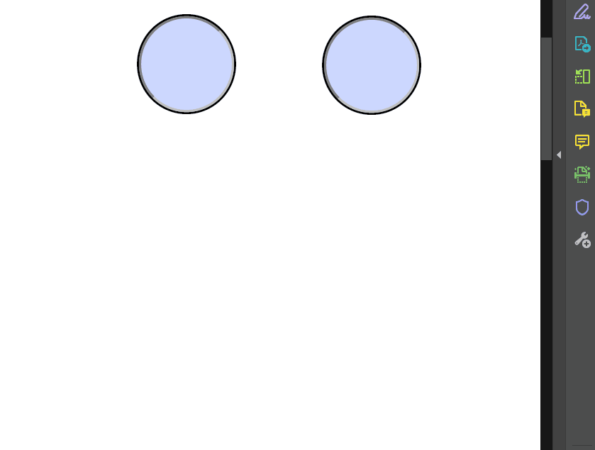

When I open the tooltip in Acrobat through > Prepare a form, it reads "Check box if you want to get hearing notices from the State Hearing Division by email". However, when I hover the mouse over the check box, it reads: "Check box if you want to get hearing notices from the State Hearing Division by email: Yes"

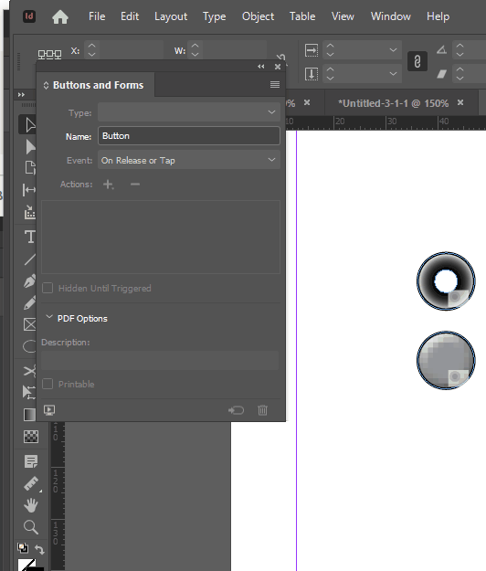

When I access Buttons and Forms in InDesign it also reads "Check box if you want to get hearing notices from the State Hearing Division by email". I translate this tooltip into Spanish in InDesign and, when I check the exported interacted PDF, this tooltip reads as ""Check box if you want to get hearing notices from the State Hearing Division by email: Yes"
My question is: Can I translate the button value in InDesing to "Sí", so that it would display in Spanish in the interactive PDF? Or would that break the radio button? Some people told me this has to do with the language Acrobat is set, but I changed it to Spanish, but it still reads as "Yes" when I open it.

If you set up a radio button in the Buttons and Forms panel, there's a "Button Value" field at the bottom of the PDF Options section. That's where you can put your translations of the Yes and No values.
In Acrobat, the "Yes" and "No" are found in the Options tab of the Radio Button Properties dialog. So if you were doing 'em manually, it'd look like this:
August 30, 2023
Thank you, Joel! Yes, I know they can be added in the sections you show, but my questions is whether that is advisable. Maybe by changing the value, I'm breaking some kind of code?
