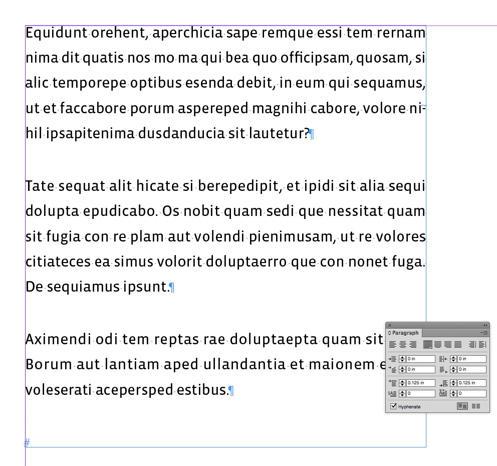

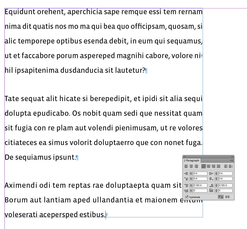

If you include a paragraph return at the end of the last paragraph you will get the space:
Make sure the last paragraph ends with an # end of story invisible
November 2, 2017
It was a very good suggestion to check for a hidden return. I turned on show hidden characters, but there was not an extra return in this case.
