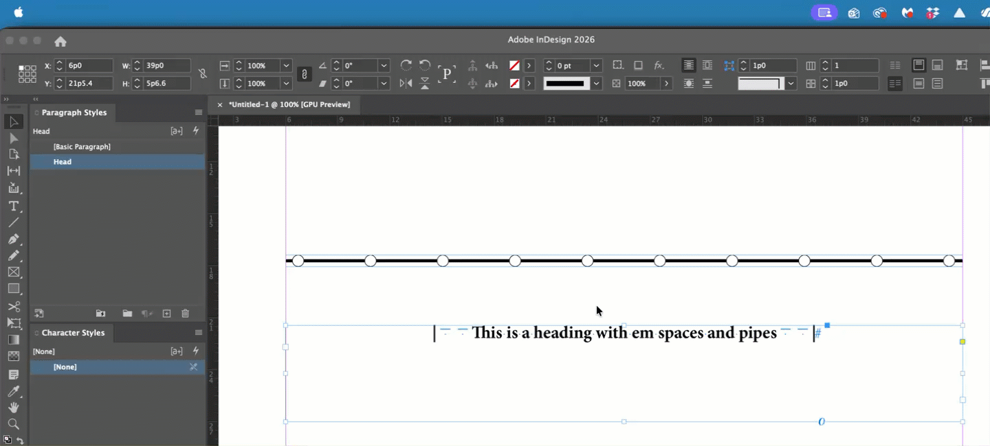

Barb Binder
Dec 1, 2025 11:04 PM UTC
Something like this might work:
  • I drew the line in Illustrator and placed it. (You could also draw it in InDesign and group the lines and circles.) I prefer Illustrator because if you edit the line later, InDesign updates all occurences and you seem to use it quite a bit.)
  • I typed the heading, adding the pipe character on either side, and spacing it from the text with em spaces.
  • I added a custom underline (thick, white and set directly behind the text to block what is underneath it) and saved the formatting as a paragrpah style so that I can use it again.
  • Used the Vertical alignment button to center the content over the line.
~Barb
