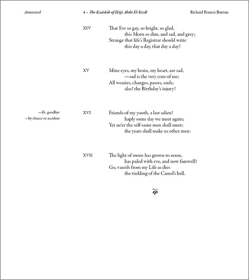

I have a blueprint for a fairly large series of books that would be produced in two forms: trimmed to standard page size, or with fairly large outer margins to contain notes and commentary. The commentary is a separate text flow from the main content. This sounds similar to what you're trying to accomplish.
The only solution I have found is to use the baseline grid and use it and various text spacing methods to hold the commentary text in alignment with the body text. Nothing too elegant about it, but it works and I have several prototype chapters.
It's possible a script could pull associated notes and place them in the commentary frame, but this sounds a bit like you are leaning towards an almost AI-like automatic annotation. Maybe there's a combination of tools that can get there, but (at a minimum) manual/intelligent placement of the commentary links would be orders of magnitude simpler.
If that doesn't quite address your question, feel free to expand!
