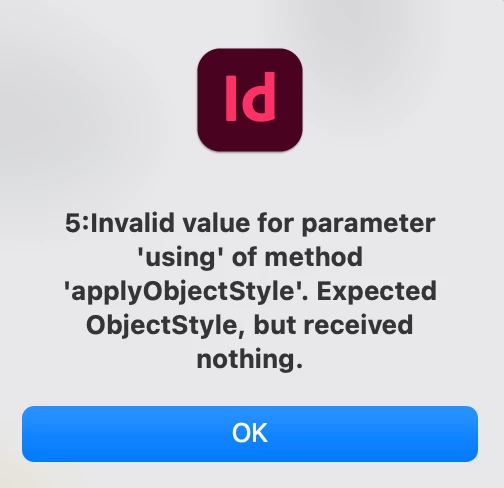

November 3, 2022
Thanks for responding! Here's the error message that I'm getting:
Loic.Aigon
November 3, 2022
I can reproduce the error with a non valid object style reference like this:
app.selection[0].applyObjectStyle(curDoc.objectStyles.item("NON VALID NAME"),true);
So you may want to both:
- use itemByName property instead of item("the name"), item() method generally expect an index (i.e. item(0) )
- check for style existence before you wanna use it (use boolean isValid):
try{
    var curDoc = app.activeDocument;
    curDoc.pages[0].textFrames[6];
    curDoc.select (curDoc.pages[0].textFrames[6]);
    var theStyle = curDoc.objectStyles.itemByName("Text 2AB");
    if( theStyle.isValid){
        app.selection[0].applyObjectStyle(theStyle,true);
    else{
        alert("Could'nt find the object style :\\")
catch(err){
    alert(err.line+":"+err.message)
But of course those kind of precheck would be useful for your whole script (is a doc open, a selection valid, etc.)
