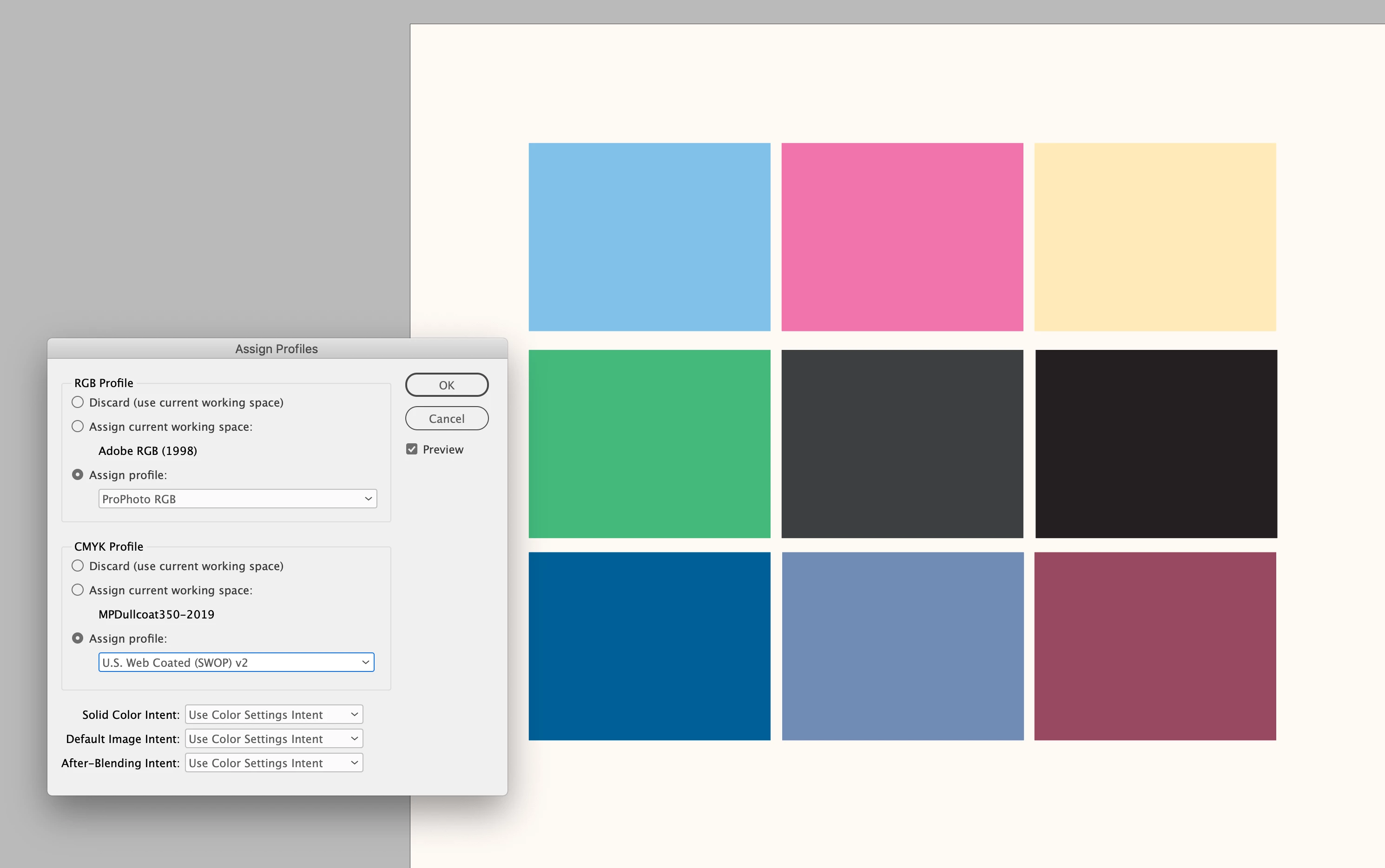

Hi @Lenou , If you are trying to simulate the paper’s color, you can adjust the [Paper] swatch as @James Gifford—NitroPress , and @Eugene Tyson  suggest. But if you want to simulate or soft proof the appearance of CMYK color on an uncoated sheet or, color manage the conversion of RGB color into CMYK, it’s important to assign an uncoated CMYK Profile to your document and set DocumentCMYK as the destination for any Print ready PDFs.
If the output is to a sheetfed offset press, and you can’t get a recommendation from your printer Uncoated GRACol would be a good choice for the CMYK profile assignment.

Thank you very much for your answer! The tip James and Eugene gave me will be useful, but yes I wanted to soft proof the appearance of CMYK color on a recycled sheet and I think it won't be possible if I only change the Paper swatch. So if I understood well, combining the Paper swatch color change and an uncoated CMYK Profile will allow me to soft proof the CMYK colors on my document on Indesign?
rob day
Mar 23, 2023 2:44 PM UTC
Yes the assigned document CMYK profile (Edit>Assign Profiles...) controls the appearance of document CMYK colors—the difference in appearance would depend on thecolor values. Here the difference between the default US Web Coated SWOP and Uncoated GRACoL—the GRACoL color appearance is generally less saturated and darker colors are lighter in value, which is what will happen on an uncoated sheet with offset printing
