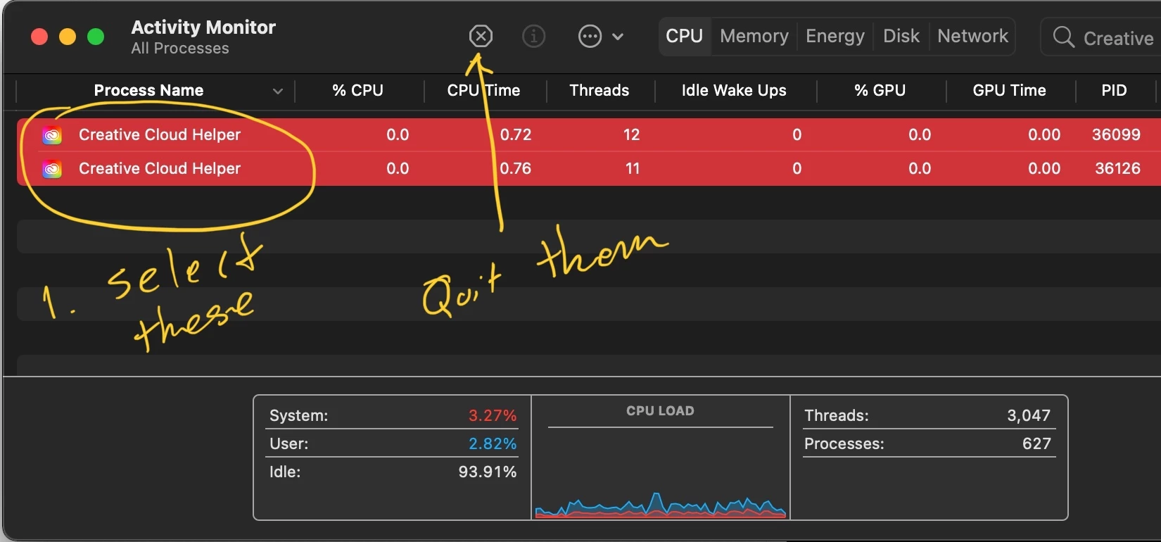

Benji-11
December 1, 2021
This is my experience...
After doing everything that people say. the spinning ball appearance again and again...
I turned off my internet, it seems it helps.
This is what I do to have fewer spinning balls.
1. Open your Activity Monitor
2. Search "Creative"
3. Quit everything that is Creative as soon as you see it.
This works for me so far. You cant try it to see if it works for you too.

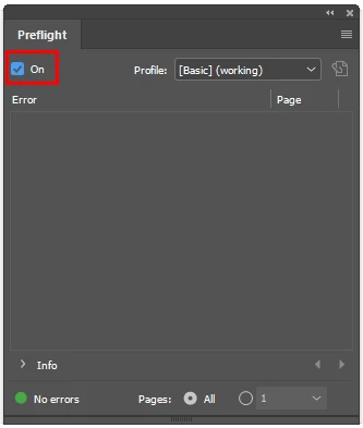

  • Please check if turning off preflight  (Window > Output > Preflight > Deselect the checkbox) help resolve the issue?

    1. Turn Off Preflight
      InDesign Preflight constantly monitors your document to see if there are any “preflight errors,” such as overset text. It should not affect much, but if you’re running into slowdowns, it’s worth try turning it off (Window > Output > Preflight > Deselect the checkbox).

Jeff Witchel, ACI
August 14, 2021
Not sure if this was mentioned or not.
Turn off Preflight in the Preflight panel. Preflight is constantly checking your document, which sometimes can bring everything to a halt. It can be maddening!
