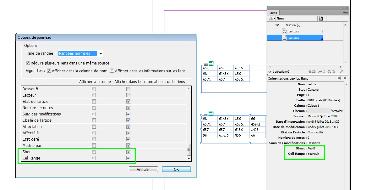

    Hi!
    Maybe WordsFlow  »  Em Software plugin is what you need.
    You can install a demo version to see if it suits your needs.
    In the links panel options, you can choose to display sheet and cell range.
    See example (I know it's French, but I'm sure you'll figure it out):

    Hi!

    Hi Vinny
    it looks as if your suggestion does what I need.
    I'll download a trial and give it a go - thanks very much!
    Having downloaded the trial it does work nicely, and gives me the handy visual reference you demonstrated.
    Unfortunately, when re-importing the data into an already styled table using the 'WordsFlow' method, the existing table/cell styling is removed and requires re-applying. If I were beginning the job from scratch it would be the perfect tool - as I am already so far through this job it would be adding to my workload.
