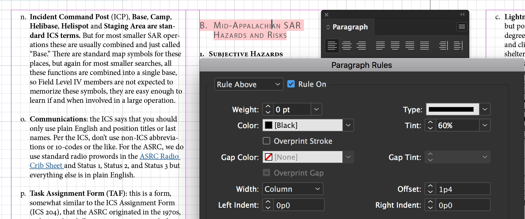

Correct answer Scott Citron
Here's your problem, Keith. Exactly as I said in my first reply to you. Your paragraph style has a 0 pt rule above applied with a 1p4 vertical offset. Disable the rule (or change the Offset to 0) and the text moves upward where it belongs.
See my Before and After screen caps below.

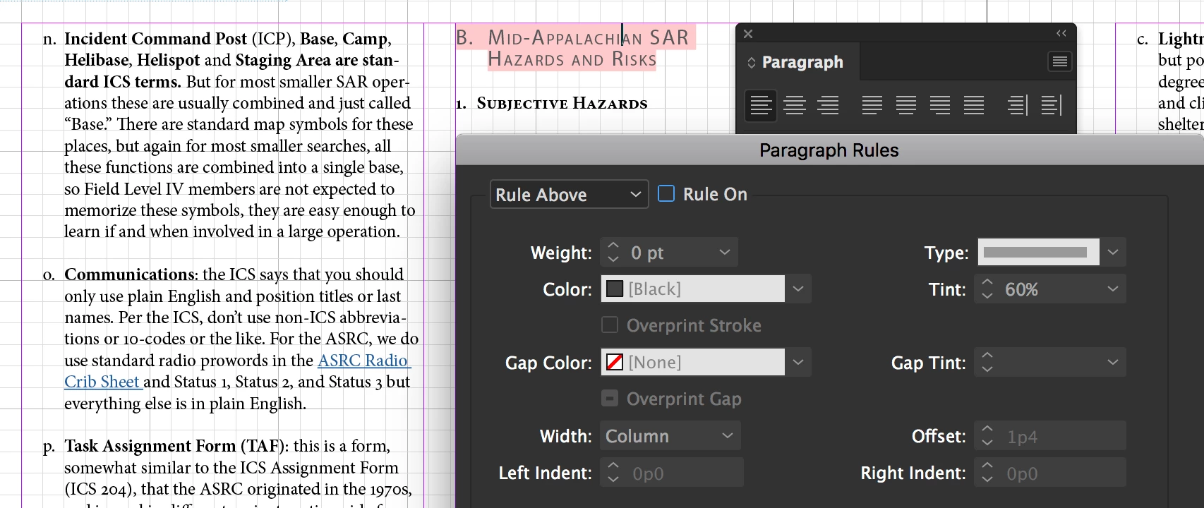

You have Rule Above paragraph defined for the A. paragraph tag with a 1p4 offset. Just disable it.
~Barb
Before:
After:
