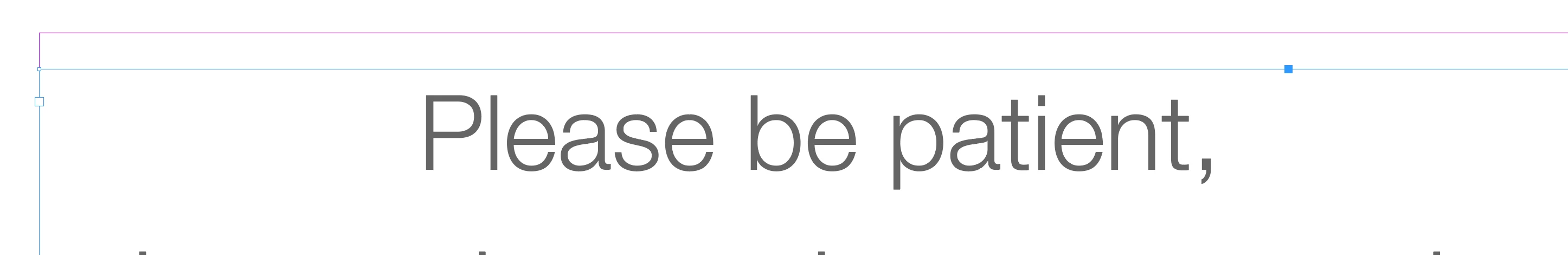

Spacing at top of text box

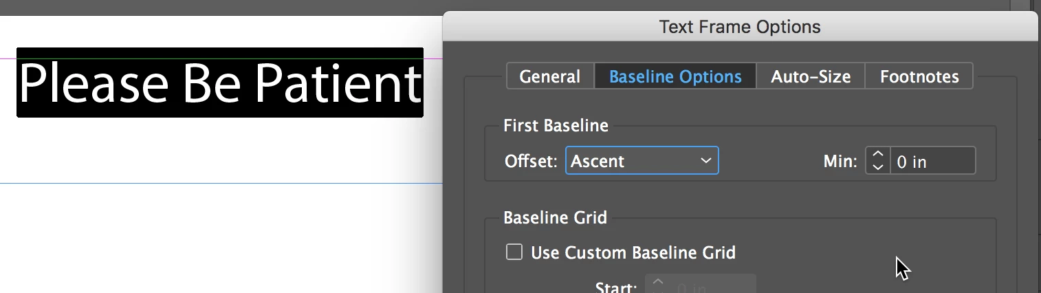

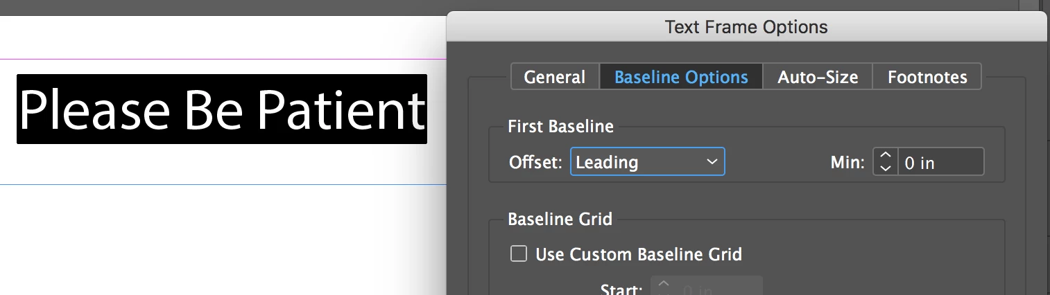

There is a default spacing between the top of the text box (blue line) and the start of the text. How do I set my preferences so the top of the first line of text touches the blue line? This is super maddening when try to center text vertically. Any help would be greatly appreciated!
Steve Werner
Steve WernerCorrect answer
Jun 29, 2017 11:17 PM UTC
Select the type frame. Choose Object > Text Frame Options > Baseline Options.
It could be a difference in the First Baseline Offset. Try Ascent or Cap Height:

Ascent didn't work. But Cap Height did! Thank you!!!
Jun 30, 2017 6:14 AM UTC
FWIW: Depending on the used font you can have problems with Ascent and/or Cap Height if you want to have an exact alignment with the top edge of the text frame:
