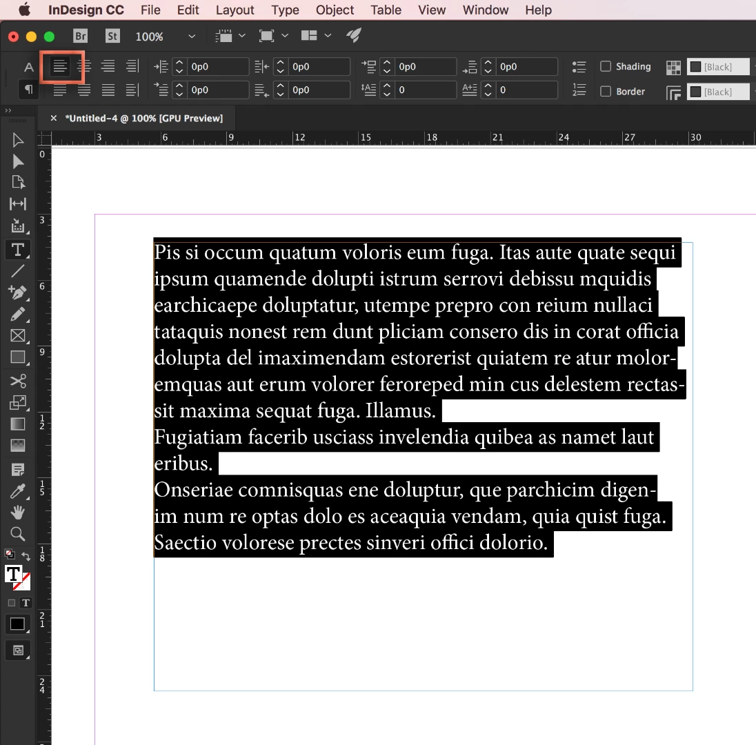

Sounds like you have text set to full justify. Set it to left align instead.

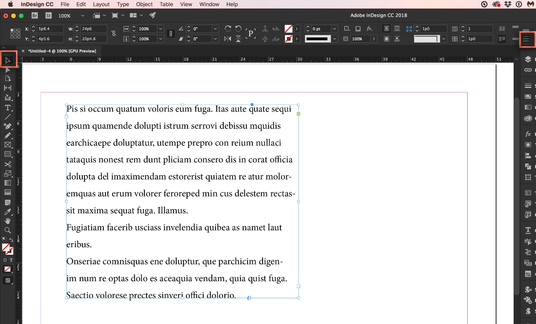

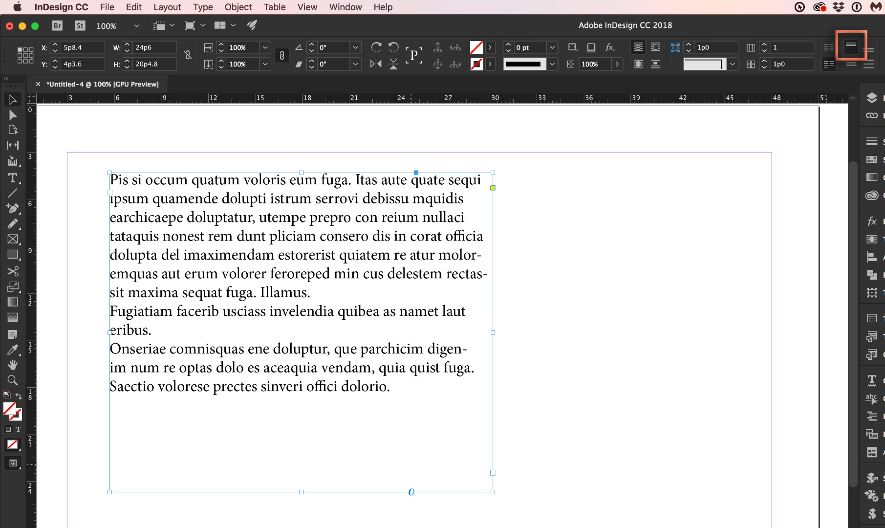

InDesign supports horizontal and vertical justification. Neither is on as a default, so it sounds like one or the other was turned on as a default by accident. Defaults are enabled when you choose a command without anything selected. To restore a default, deselect all and then choose the desired command.
Bob addressed horizontal justification:
But since you didn't specify which or show a screen shot, note that you can also disable vertical justification:
~Barb
